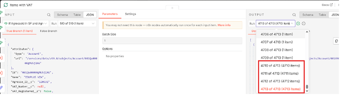

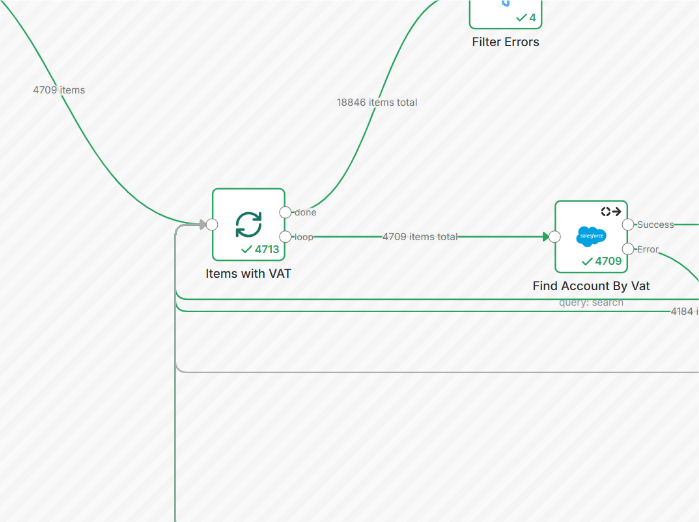

Observed behavior:
  • During workflow execution, the node seems to correctly process items in batches through the loop branch.
  • However, at the end of the processing (when the loop finishes and data should go to the Done output), the output data appears to get doubled / duplicated.
  • In my case, what should be a single set of processed items ends up duplicated (and sometimes split), resulting in 2×, 4× (or more) items than expected.
  • Downstream nodes (e.g. Aggregate, Code, or any processing node) receive this multiplied data.
  • As a result, nodes after the loop get triggered multiple times (in my example: 4 times instead of once), depending on the data size and how the duplication occurs.

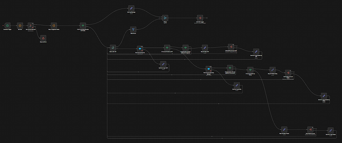

Unfortunately it’s not allowing me to add the workflow or attach a file to either my original post or to this reply, I’ll try again tomorrow. I’ve also tried to switch back to the standard markdown editor but without success. I’ve added a screenshot of the workflow just to give you an overview of it.
I forgot to mention this in my original post, but the workflow worked without any issues in a previous version of n8n. After updating our instance to version 2.4.8 is when we first started to encounter this faulty behavior. This is the first workflow in which we’ve noticed this change in behavior but we’ve got other workflows in which we need to do some steps after the done branch where the same faulty behavior occurs.
