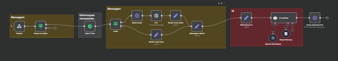

To give you some context, my project is an independent agent on WhatsApp, but it keeps giving me an error (Cannot read properties of undefined (reading ‘map’)).
This error occurs when I modify anything in my workflow, even when I return to the previous state, it keeps giving me the same error. Furthermore, apparently this only happens with some phone numbers (it happens to me and my boss, but not with some clients).
is the AI Agent are calling some tools? and are you using any dynamic value to be filled? because the error seems to say that there are missing values that it expects it to have but seems to be empty
maybe if you can give more screenshots or explanation it would be best
Seems like you using AI Agent, can you show it to me pls? I can help you to solve your problem!
My workflow:

(Entrada) API Webhook that I use to connect to whatsapp
(Audio, Baixar audio, Mudar nome audio, Mudar nome texto Mensagem cliente) If the message is audio, it is transcribed and has its name changed; if it is a text message, its name is changed
(Alimentacao IA) AI receives the information on how it should proceed
(Resposta IA) AI creates the response
(Envia resposta IA) sends message
I put everything in @fahmiiireza comment.
can you show us the response from Alimentacao IA edit node?
In the AI Agent, on the Prompt (User Message), can you put {{ $(‘Mensagem cliente’).item.json.Mensagem_usuario}} instead of just {{ $(‘Mensagem cliente’).item.json}}
try and see if that fix your issue
hi there, if i help solve your question please mark my answer as the solution @Matheus_Marzari
