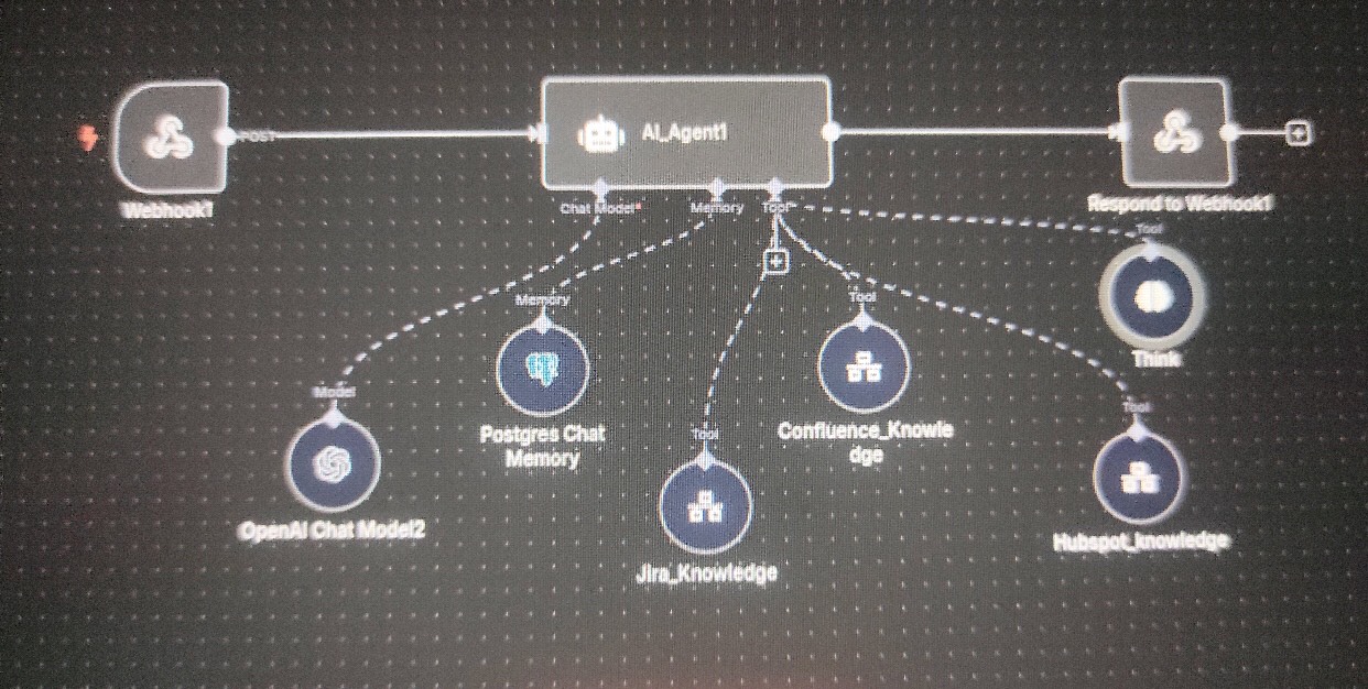

This is the workflow

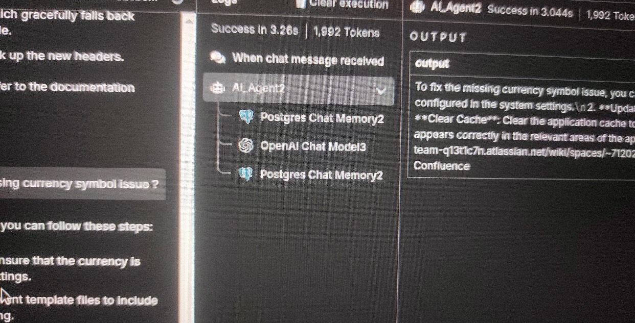

So here you can see when I reached 7 queries it directly responded before it was working fine
There have been other reports in deterministic Nth+ interactions skipping tools, especially for GPT 4o mini. I would test to verify if this is a model issue or a sub-node issue:
  • Reproduce with a minimal agent: one trivial tool, no memory, GPT‑4o‑mini; send 7 consecutive turns and confirm whether the pattern disappears without memory/sub-nodes.
  • Add only Postgres Chat Memory and retest; if the issue reappears, note the turn on which tools stop and whether tool_calls is empty in execution data.
  • Go back to full setup, remove the Think tool and retest;
  • Switch the model to GPT‑4o or GPT‑4 Turbo and retest
Basically test step by step so you can find which setups are working (if any) and which fail on the 7th try, by gradually adding more sub-nodes.
