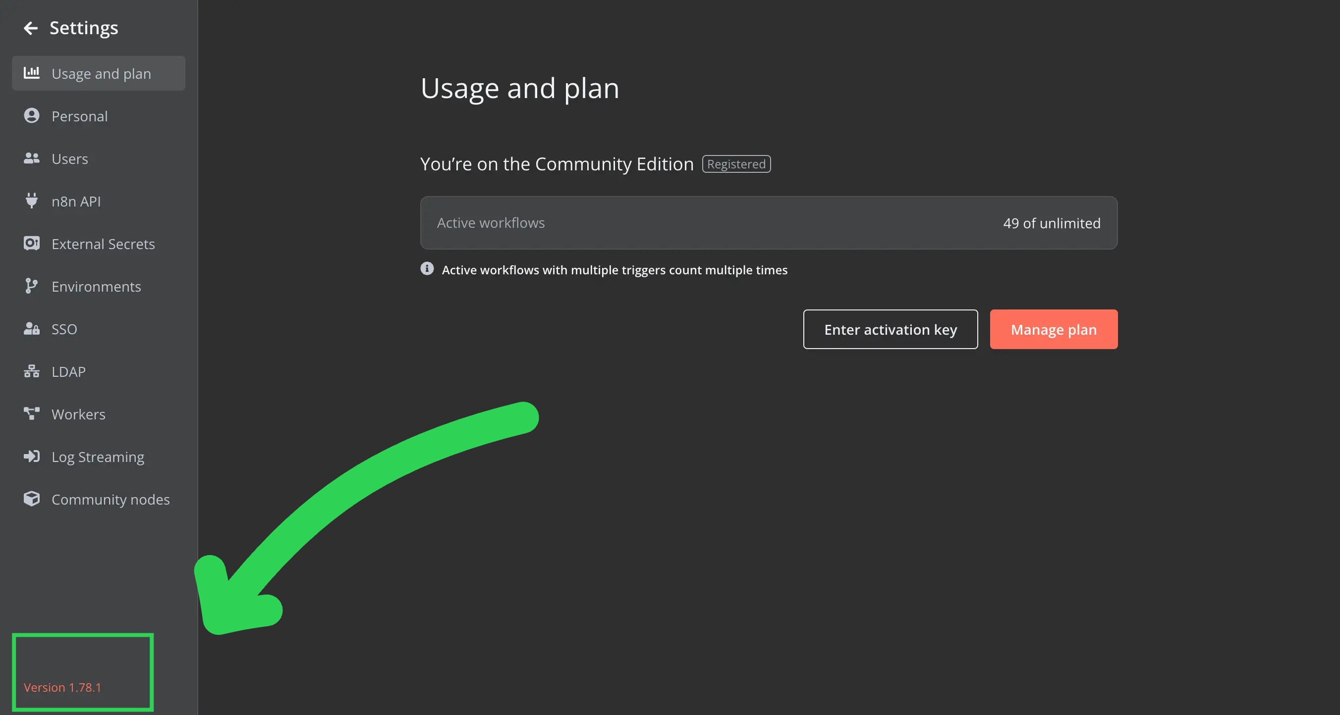

n8n version: 1.78.1

Can you please check again that you are on the 1.78?
You could check this in the “About n8n” dialog under the help menu in the sidebar.

Are you running n8n in queue mode by any chance?
yes. i have workers set up in n8n

it sounds like those workers might be running an older version.
thanks. yhou are right. i updated snd it works fine now!
