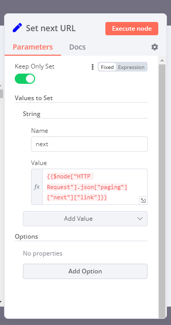

Hi @giulioandreini
It’s almost worked but in the “Set next URL” note don’t how should I do
What am I missing?

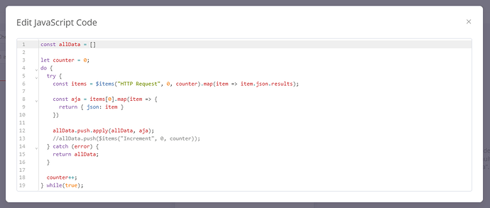

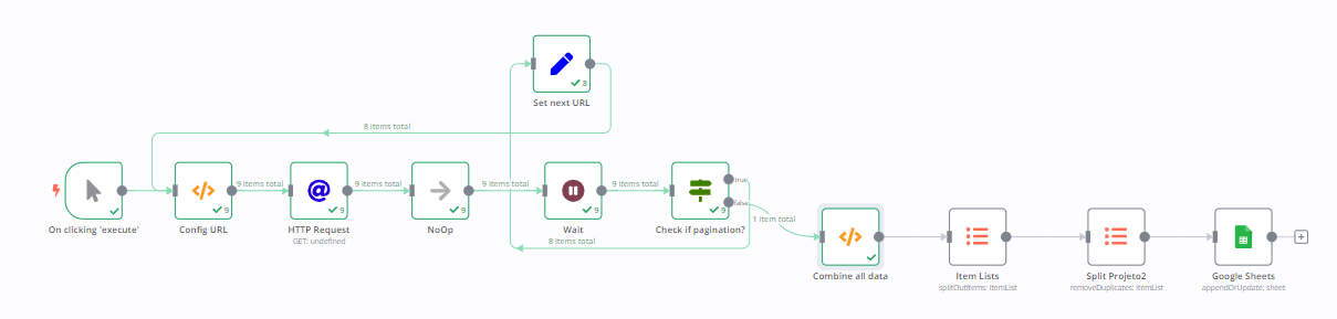

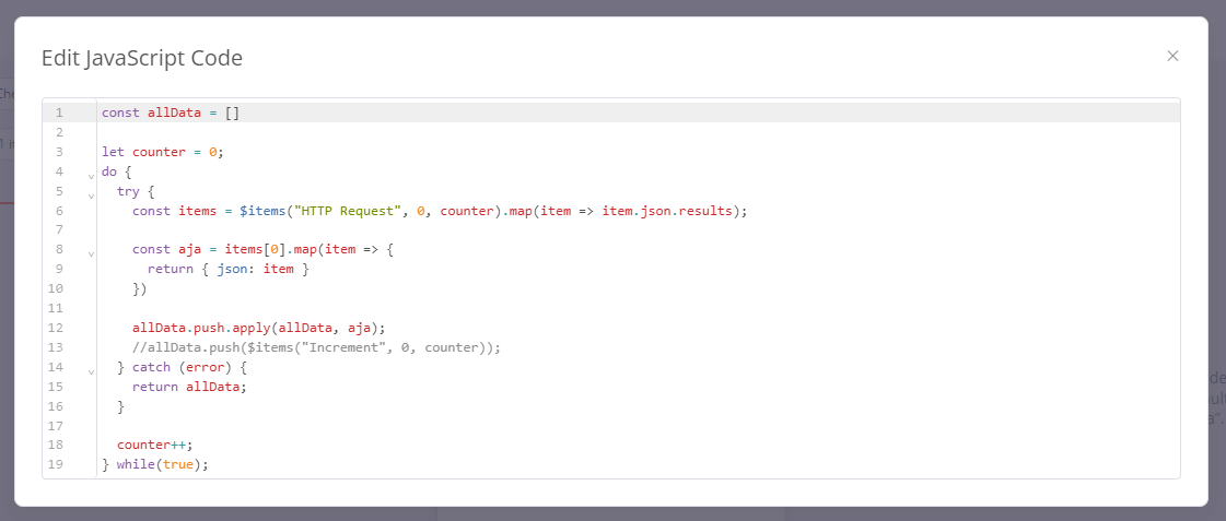

Hi @giulioandreini
Update: I did it! My problem now is when I finally get all data there is no output data returned from the “Combine all data” node.
I left my JavaScript code in the print so you can see what I’m doing wrong
May you help me?
Hey @Lucas_Santos,
Have you tried using something like the below to start?
let results = [],
  i = 0;
do {
  try {
    results = results.concat($("HTTP Request").all(0, i));
  } catch (error) {
    return results;
  i++;
} while (true);

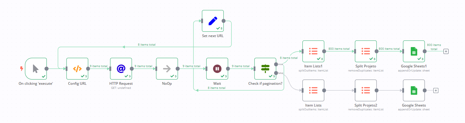

Hey @Jon
I will no longer need to combine all the data. Instead, I will append my results to Google Sheets. In this way, it worked precisely as I expected!
