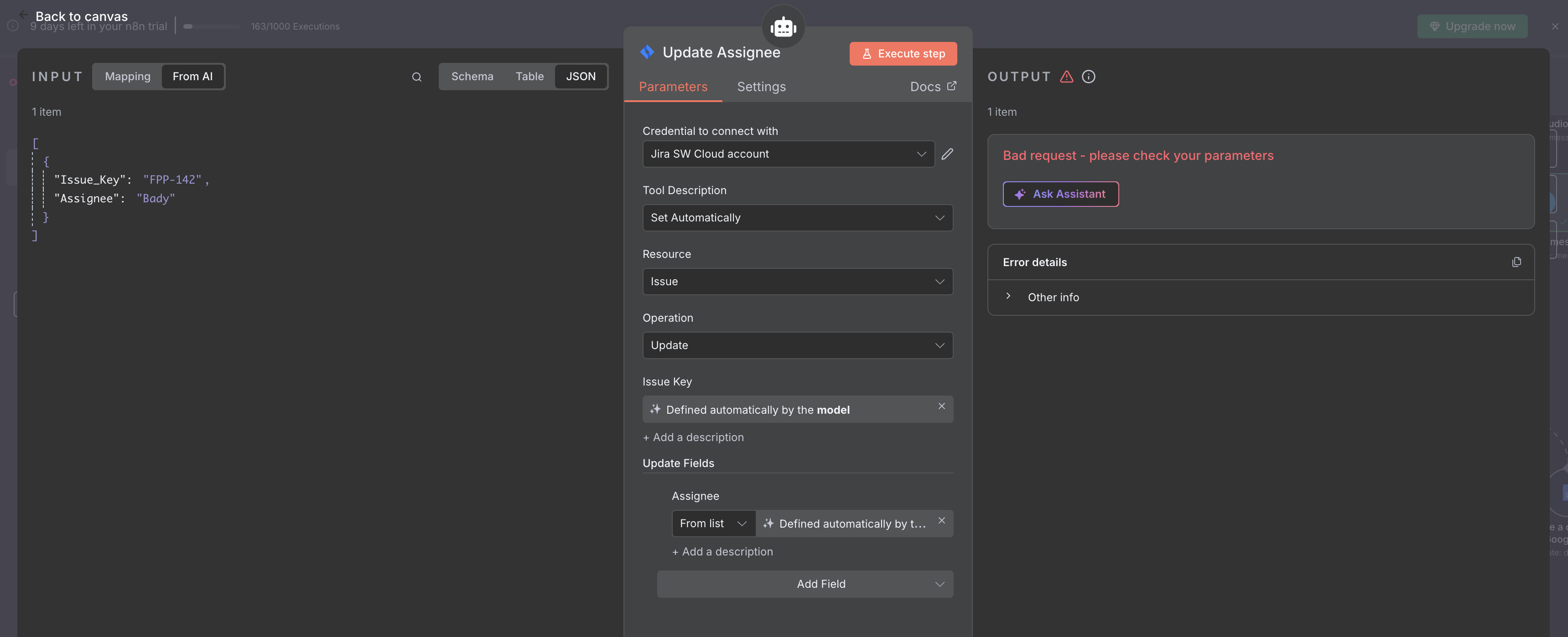

When I try to use Jira Tool to update Issue Status I always receive “bad request” response. I tried using status name “Done” and tried using the status ID “100032” Neither have worked.

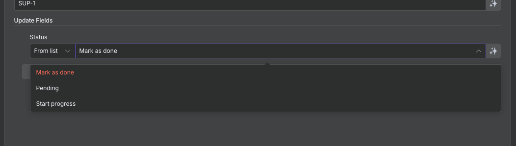

Is there a reason you don’t want to use “Mark as done” option from the fall down menu?
I tried and it didn’t work. Jira doesn’t seem to support changing status using the update status field. It only work through what is called “transactions”
I was confused by that. I mean if this is not supported, then why does it show as an option in Jira node?
I just tried changing the status of the support ticket in Jira via Update and “Mark as done” dropdown and it worked for me just fine.
Hmm, I have just retested it now and you are right. If I manually select a status from the list it works.
What I was trying to do is the let the model pick the status based on the user input. Which I was never able to let it work. I tried using the status string and the status numeric ID. No luck.

It seems like the AI Model can not interact with “From List”

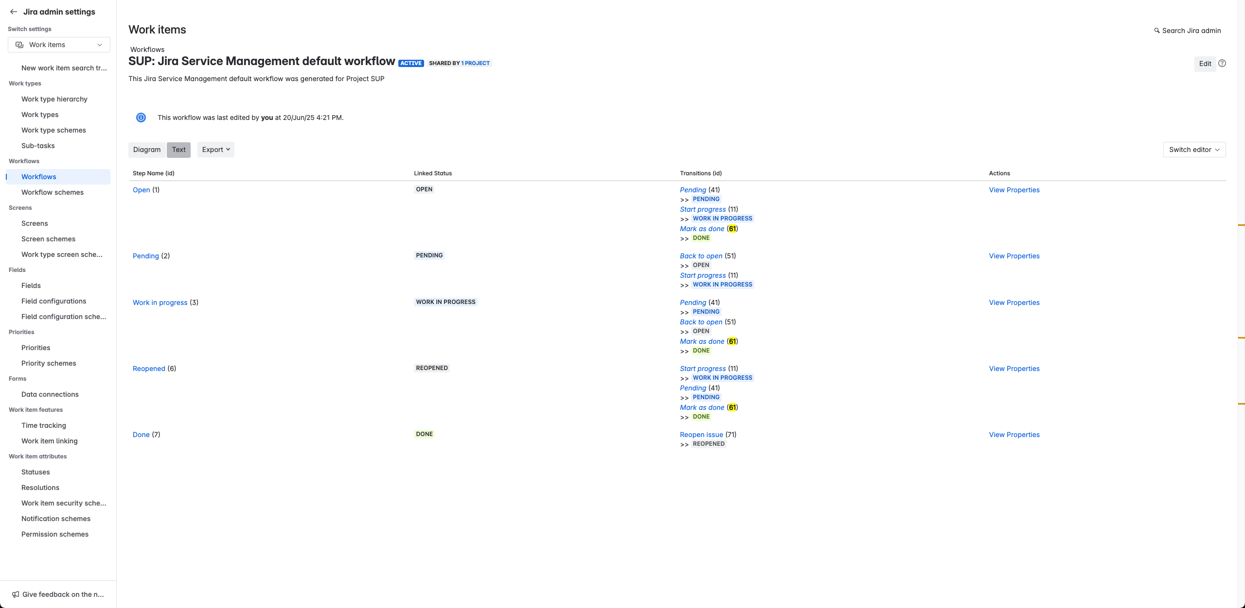

The way to get this field is either with api call to get transition ids (there got to be one) or just look them up manually on this page:
See Mark as Done is transition id 61. This is the id you will need to use to change status. So basically when setting the status you don’t use the status id, you use a transition id, where each transition id sets the destination state of the issue.
