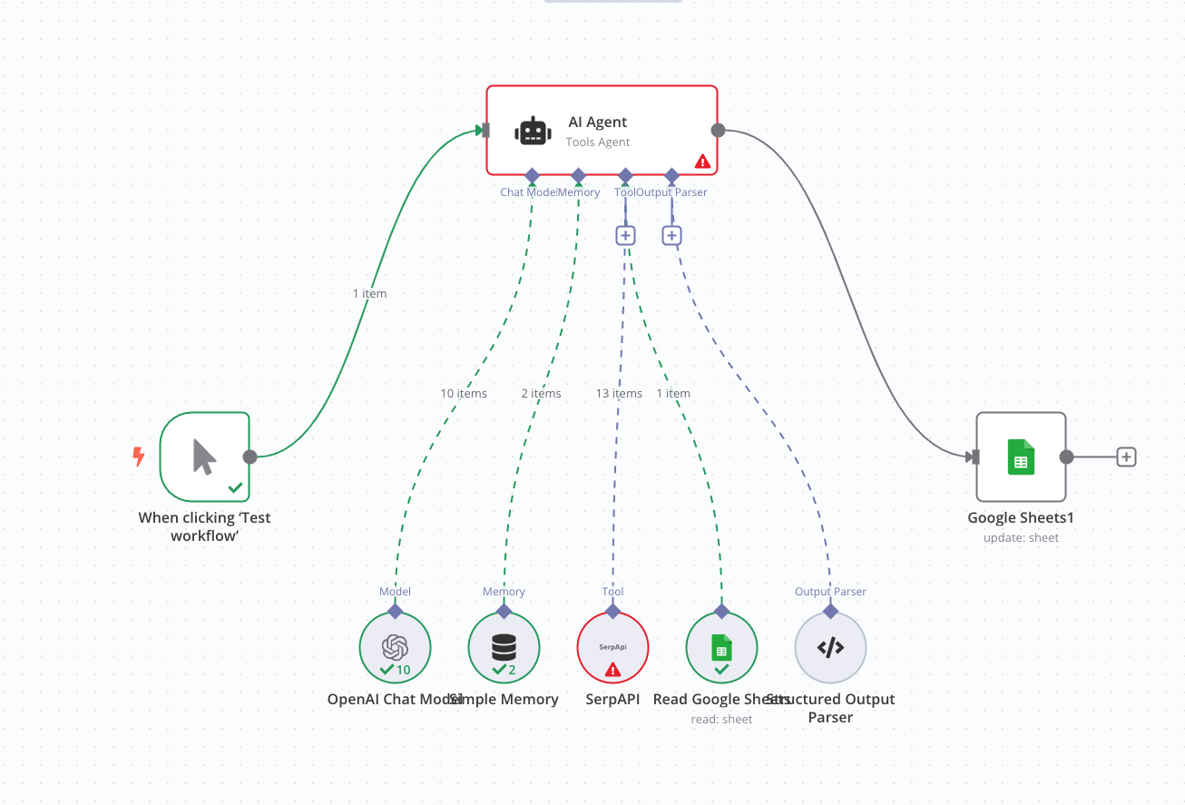

Hello,
I am using an AI bot to search for address for the names in a google sheet. However, it is only updating the first row of data. I’ve tried adding to the prompt to update more, but not sure what I’m missing.

Try creating a row number in the google sheet. Then this flow will work. I created a wrkflow where it pulls data in from the google sheet, and merges the data on the row number. Then updates the sheet with the coresponding row number.

Here’s how I would do it. As a tool, the agent doesnt bring in one row at a time. Bring the google sheet in as a get row first, then feed it to the agent. I tested with myself, so this code has a different city. But should work for you.
