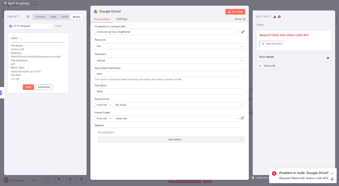

"Upload File" Google Drive node with Service Account not working
REALLY need help here!!!
I’m not managing to use “Upload File” Google Drive node with Service Account.
Basically:
“Create Folder” works with Service Account.
“Upload File” works with OAuth.
“Upload File” does NOT work with Service Account.
I’ve tried to repeat the process with another n8n Workflow, another n8n Account, with another Google Service Account, with another Google Workspace. Always the same problem.
Problem in node ‘Google Drive1‘
Request failed with status code 403

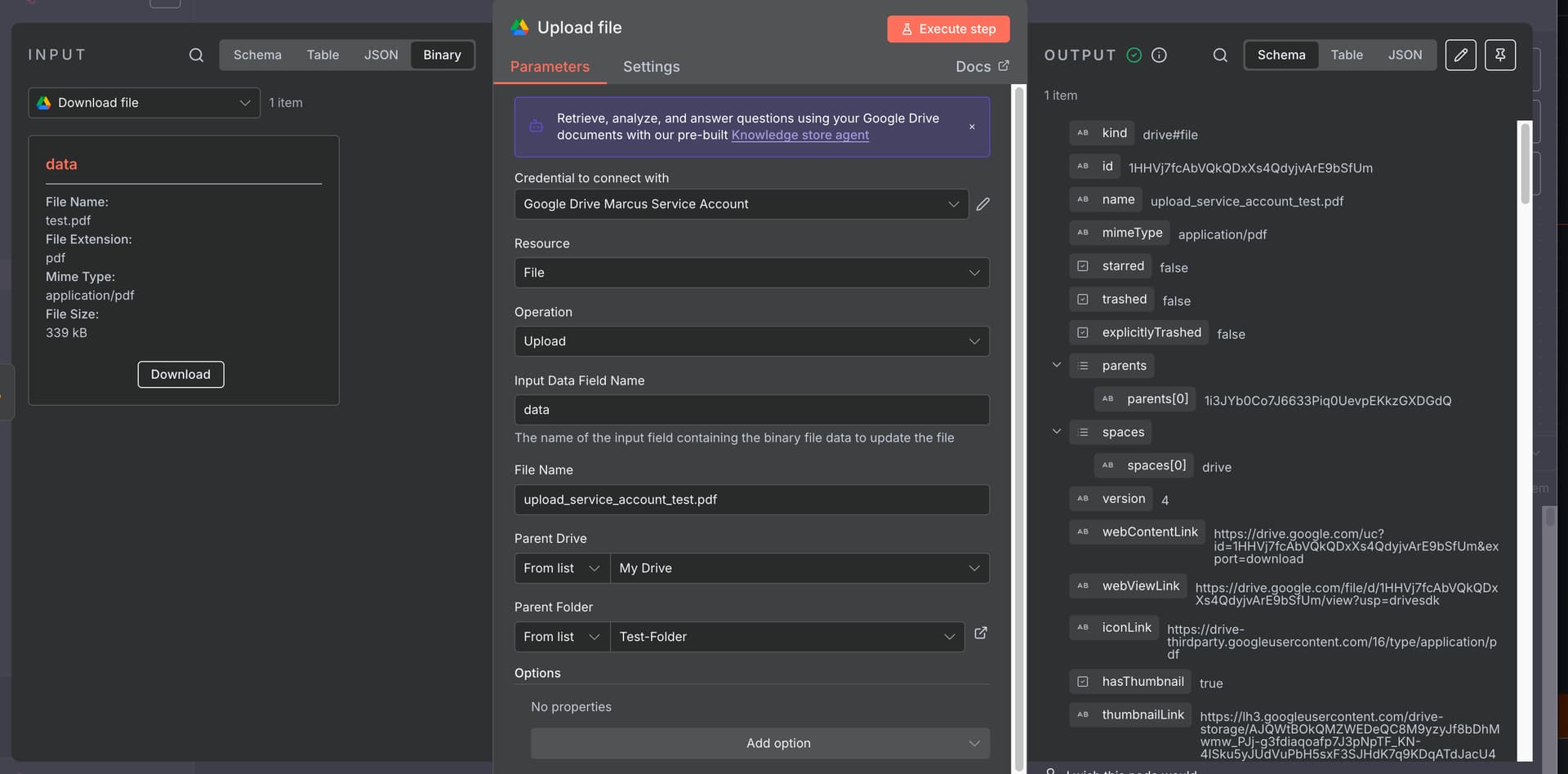

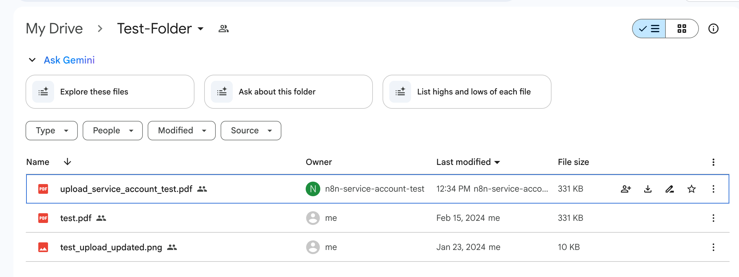

Hey folks, I’ve just tried it with n8n@1.107.3 and it was working for me with a service account.
  • To upload to my drive I had to invite the service account user (email) as editor to a folder.
  • For shared drives I had to invite the service account user (email) as editor to the drive.

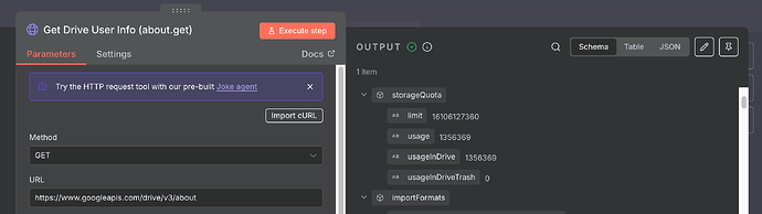

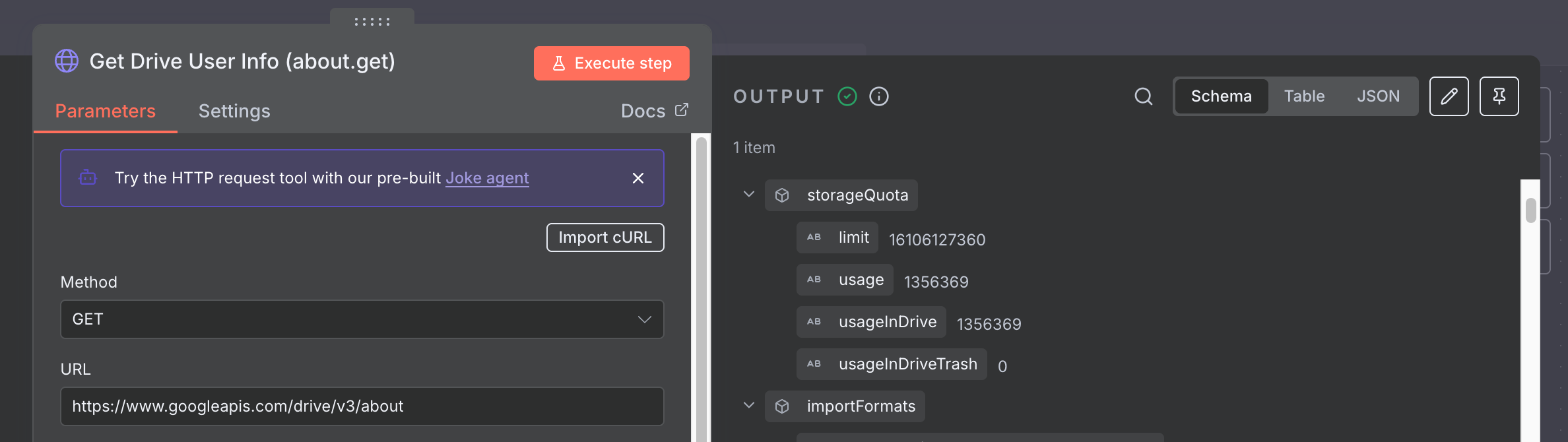

My old service account has a storage quota:
You can test it yourself using an HTTP Request node using your service account credential (with http node usage option enabled). For scopes in the service account credential you can use: https://www.googleapis.com/auth/drive, https://www.googleapis.com/auth/drive.appdata, https://www.googleapis.com/auth/drive.photos.readonly

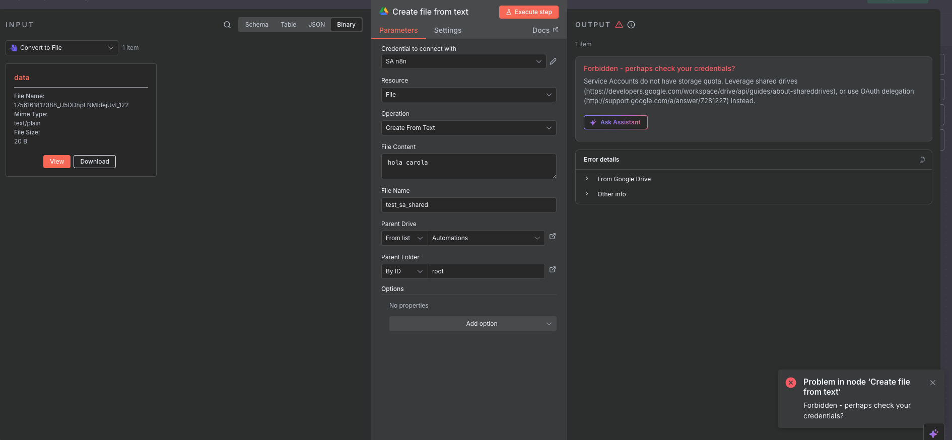

Hello @marcus, thanks for your reply.

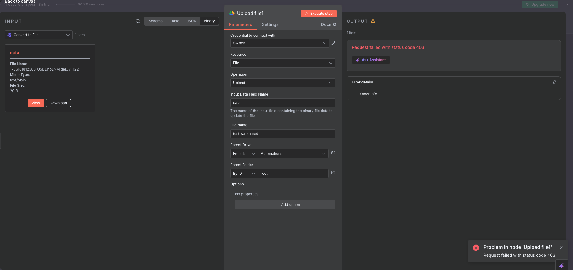

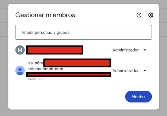

I tried creating the file in a shared drive and the error obtained is 403 (image 1).
I’m using a SA with maximum privileges on the Shared Drive (Administrator).

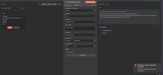

Now, when I create the file from text (image 2), there the error tells me it is related to StorageQuota. Based on the error messages given as output, they seem to be 2 different types of errors. The strange thing in case 2 is that the SA cannot create the file (even though it’s a Shared Drive and the SA has maximum privileges on said Shared Drive).
Thanks!
Image 1
Image 2
Hey @tincho,
I dug a bit deeper and can confirm that the way we upload files to google shared drive is incompatible with the permission change to service accounts since April 2025. So uploading via service accounts seems broken.
I am currently working on a draft fix to send to our node engineering team and will update this thread accordingly. Sorry for all the trouble but the permission change from google went under our radar.
