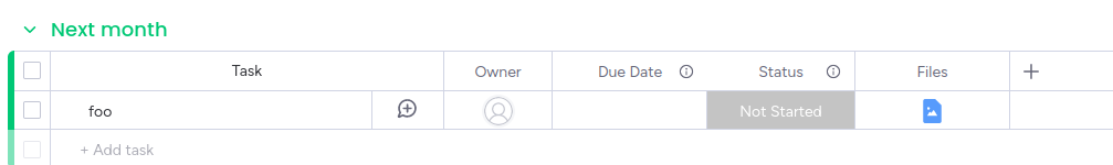

Hi @pedrofnts, the below workflow did the job for me (this is based on their Postman collection):
Just replace the item_id and column_id as needed. The request returns the ID of the uploaded file (I think) and the file shows up in Monday as expected:
Hope this helps!
