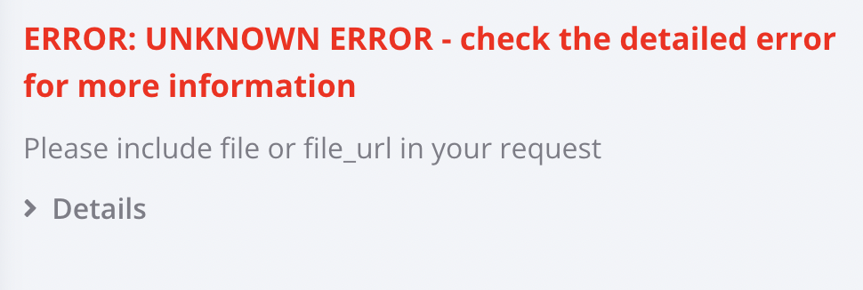

So I need to recreate this curl comment on the n8n HTTP request node
curl --location --request POST ‘https://api.publit.io/v1/files/create?%26api_test%3Dtrue%26=
–form ‘file=@“Leptiri.jpg”’
As I understand, this is the setup I should have with the nameKey:fileName as the binary property. But for some reason, the API kept returning an error request saying I missed the file parameter required in the API. Any help to point out the mistakes that I made?

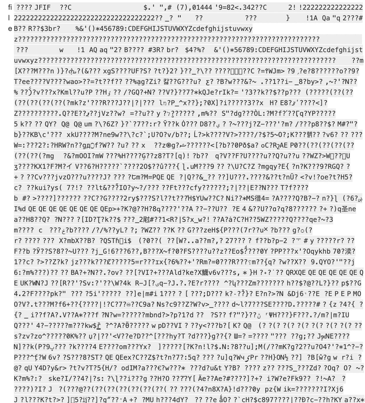

so I don’t think the request is the problem my request never arrived with a file instead just bunch of binaries.The file I’m trying to upload is sourced from the Drive Download Node & I tried uploading it back to google drive & it uploaded just fine.
Does the upload work fine if you use my example workflow to download a file?
If so, could you share the shortest possible example workflow using which you were able to reproduce the problem (simply select it on your n8n canvas, press Ctrl+C and then insert the code here on the forum)?
Also, did you set the File ID in your Google Drive node? It seems empty on your screenshot.
This is the simple download google drive file & upload to publitio function that reproduce the file required error. & I’ve tested other form of downloading file through the http request & tried uploading to Publitio & the webhook test & indeed they both arrived as a file. So it’s 100% a problem with the file. Do I need to do anything to convert my downloaded file from Drive?
ok so I’ve figured out I skipped the file name option which screwed up the file even though I was still able to view it inside the n8n editor. Now that I properly named my file & extension. It uploaded just fine. Thanks for the debugging help!
