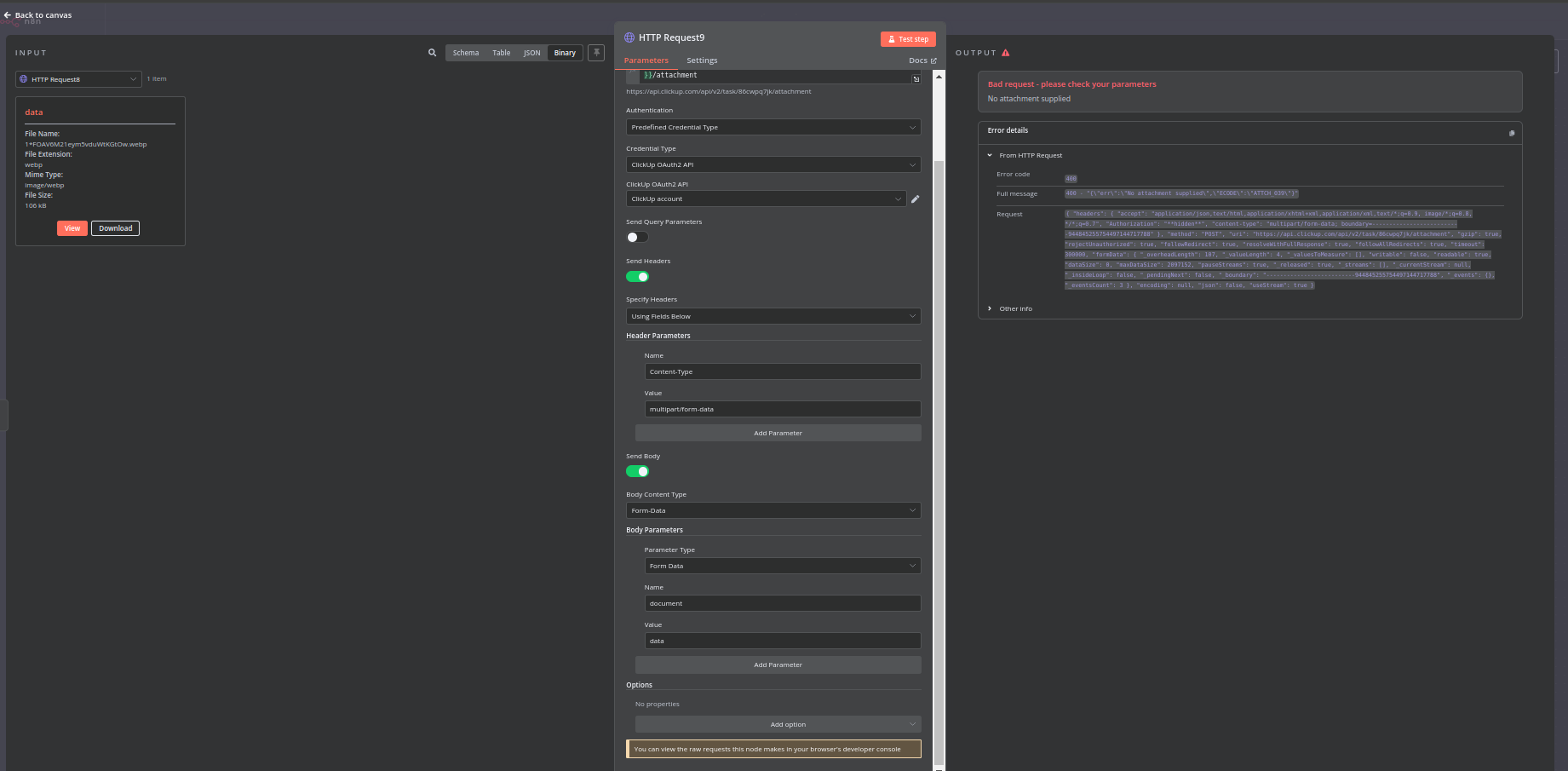

I am trying to upload a attachment to my Clickup account. My workflow is a big one , so I will just add 2 nodes where I am stuck.
  1. I am fetching the file through image url using HTTP get method. Working properly.
  2. I am trying to upload that attachment to my clickup task using another http node with POST method.
I am not able to achieve this, It is throwing me error and I am stuck with what o do.

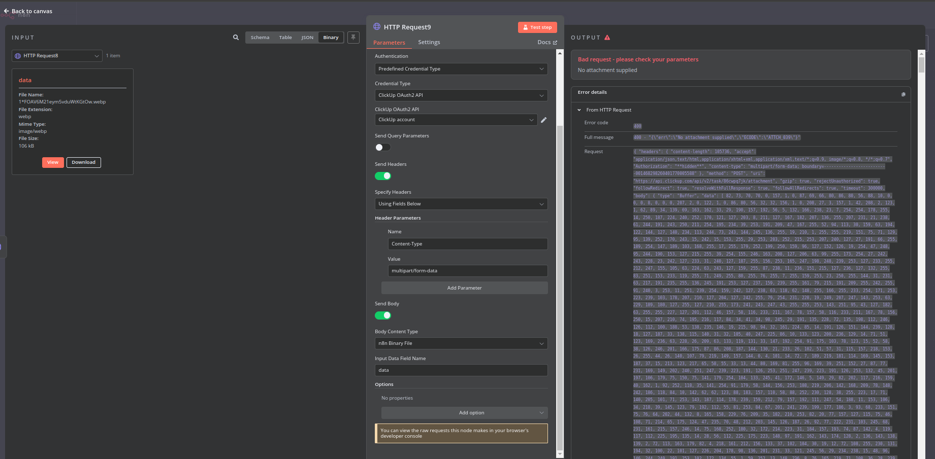

I am attaching the screen shot tried with Formdata and n8n binary file option.
Please let me know what I am doing wrong

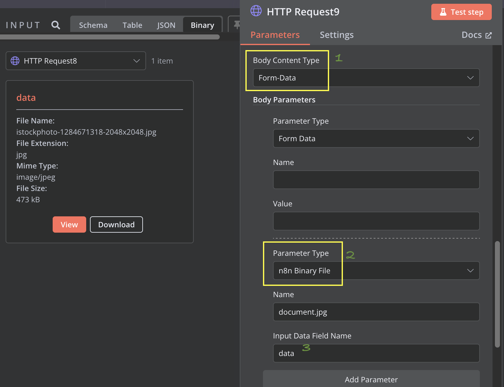

Hey @Mohammed_Imran , I would expect a different configuration of your 2nd HTTP Request node. The binary file has to be added as part of Form-Data content type.
Hi @ihortom I tried the solution you mentioned above. It is still not working. Could you please help me out? It is throwing erro of invalid field and value.

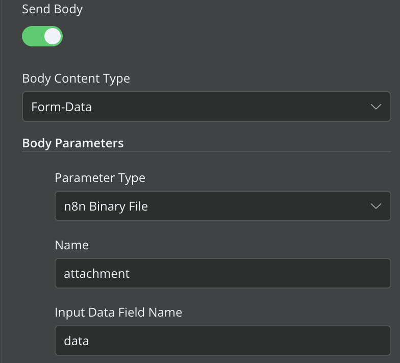

Hey @Mohammed_Imran , their API is described here, Create Task Attachment. Here’s what made it work as an example
An important part is to use the name as “attachment”.
Thank you @ihortom . This worked for me. Thanks a lot
