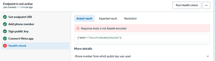

I am building Whatsapp Flows for which I need to send the data to my N8N webhook. Facebook/Whatsapp Business Manager demands the response to be in base64 String however (as you can see in the screenshot attached). What would be the quickest and best way to achieve this?

Problem is it doesn’t reach the edit fields or code node. I selected that the respond to Webhook should be the one that sends the response. It’s because I clicked on Test webhook I guess it didn’t process further.
But anyways you manually entered „ok“
How can we send the actual response of the webhook to base64.

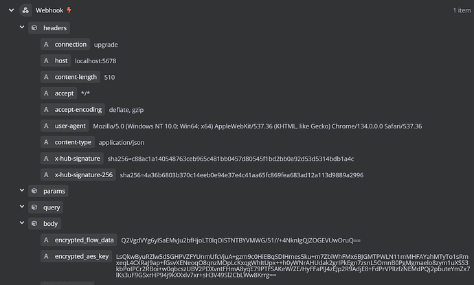

Used that exact workflow from above.
Still says wasnt base64 encoded.

Regarding to your workflow only a value in encoded.
Maybe the whole json document should be encoded.

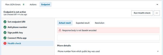

I’m having the same issue here. Been trying to solve if for the last 10 hours straight :confused:
I simply can’t decrypt and encrypt the content. The suggested code by Meta doesn’t work on n8n. Can you please help?
