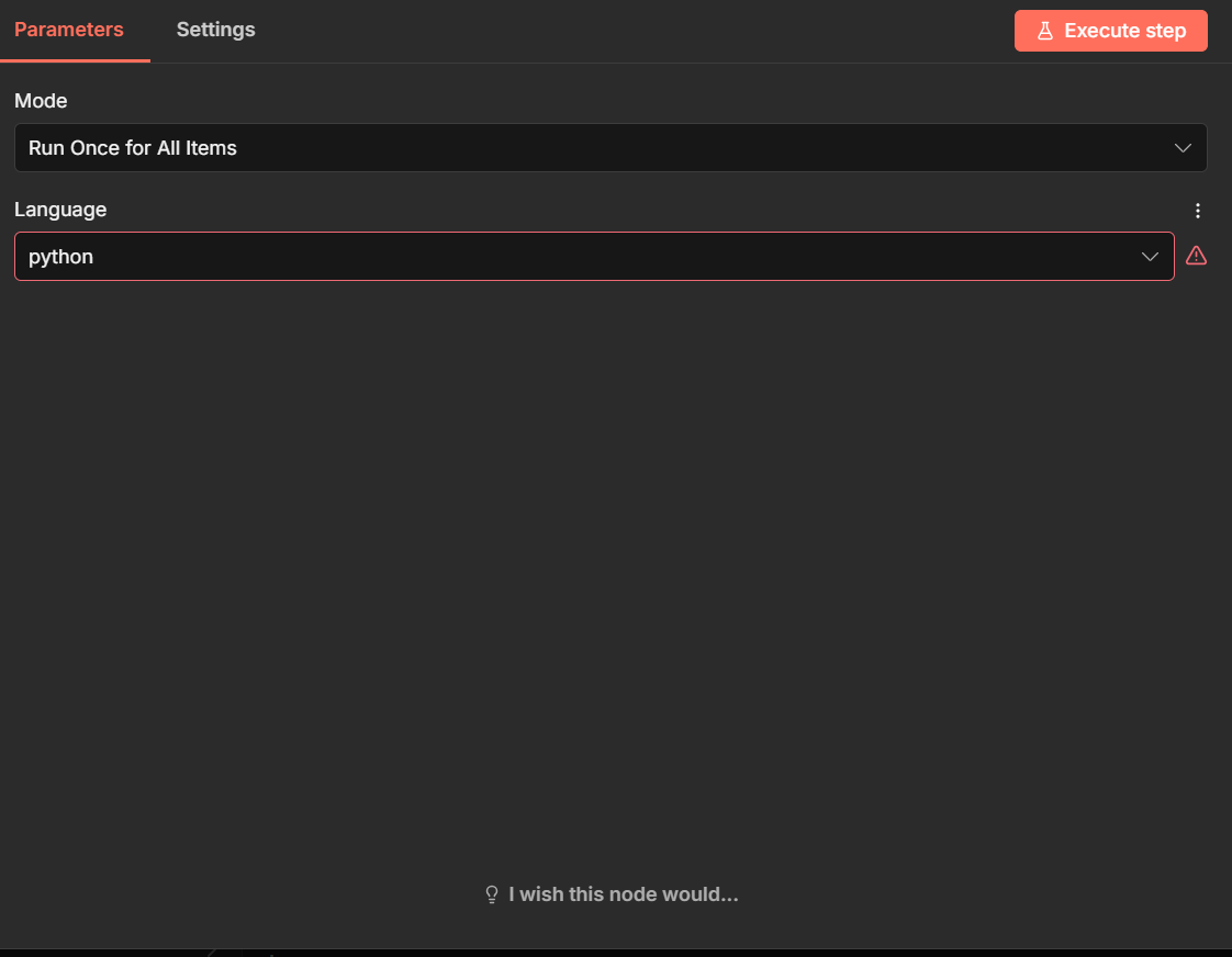

Urgunet help needed. Pyodide code is gone and not visible after updating to v2.3.5
After I updated my environment to v2.3.5 from v1.123 (most likely, didn’t notice the exact version), all my Python code nodes that contained Pyodide code, are not showing previous code at all. I was aware about the breaking change but in my understanding I should be able to just modify the code after update to follow the change. However now I can’t see code in any of my nodes. After I select Python or JS, it just resets it to plain example.
This is just an example of a node, I have around dozens of them across many workflows
Problem in node ‘Combine preferences data‘
Could not get parameter
By that output I suppose that previous code that was using data retrieving from previous node with _input.all() still exists somewhere but is not visible for some reason.

That’s what I have in the object of code node:
“parameters”: {
“language”: “python”
“typeVersion”: 2,
“position”: [
64,
-160
“id”: “8c04bc05-6234-41fd-a912-33a13e12b942”,
“name”: “Combine preferences data”,
“executeOnce”: false
Don’t see code here unfortunately

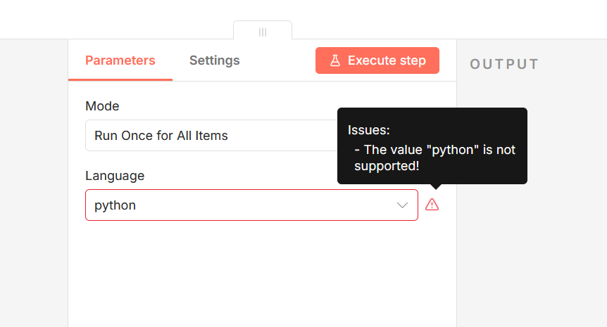

Same problem here. In my case, every execution before the update is gone.
yes, no code displayed there as well and the same error in Language field that python value is not supported
same problem here
i’d say horrible experience with the latest updates, disappearing nodes and codes
Thanks a lot for bringing the problem to our attention. That was definitely not intended like that. Sorry for the problems it caused. A PR has already opened to fix the issue:
Just updated to version 2.3.6, but the issue still persists.
New version [email protected] got released which includes the GitHub PR 24511.
