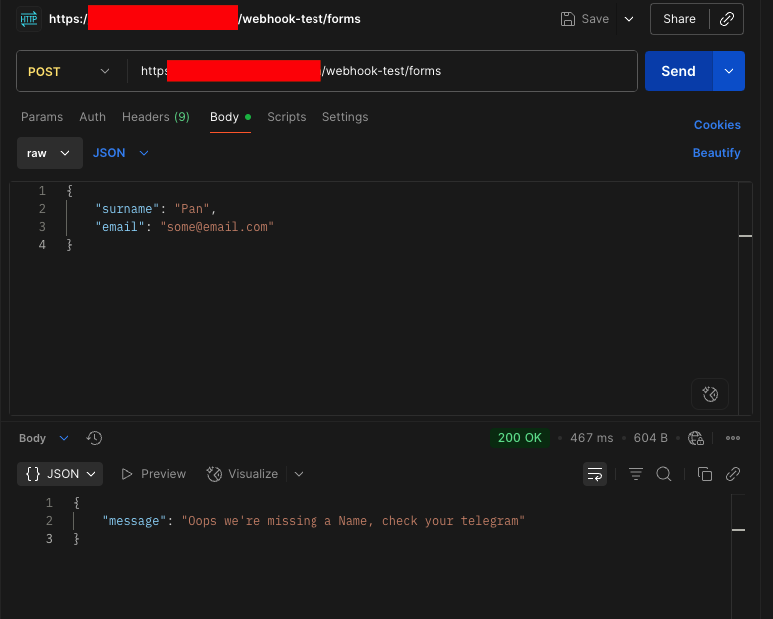

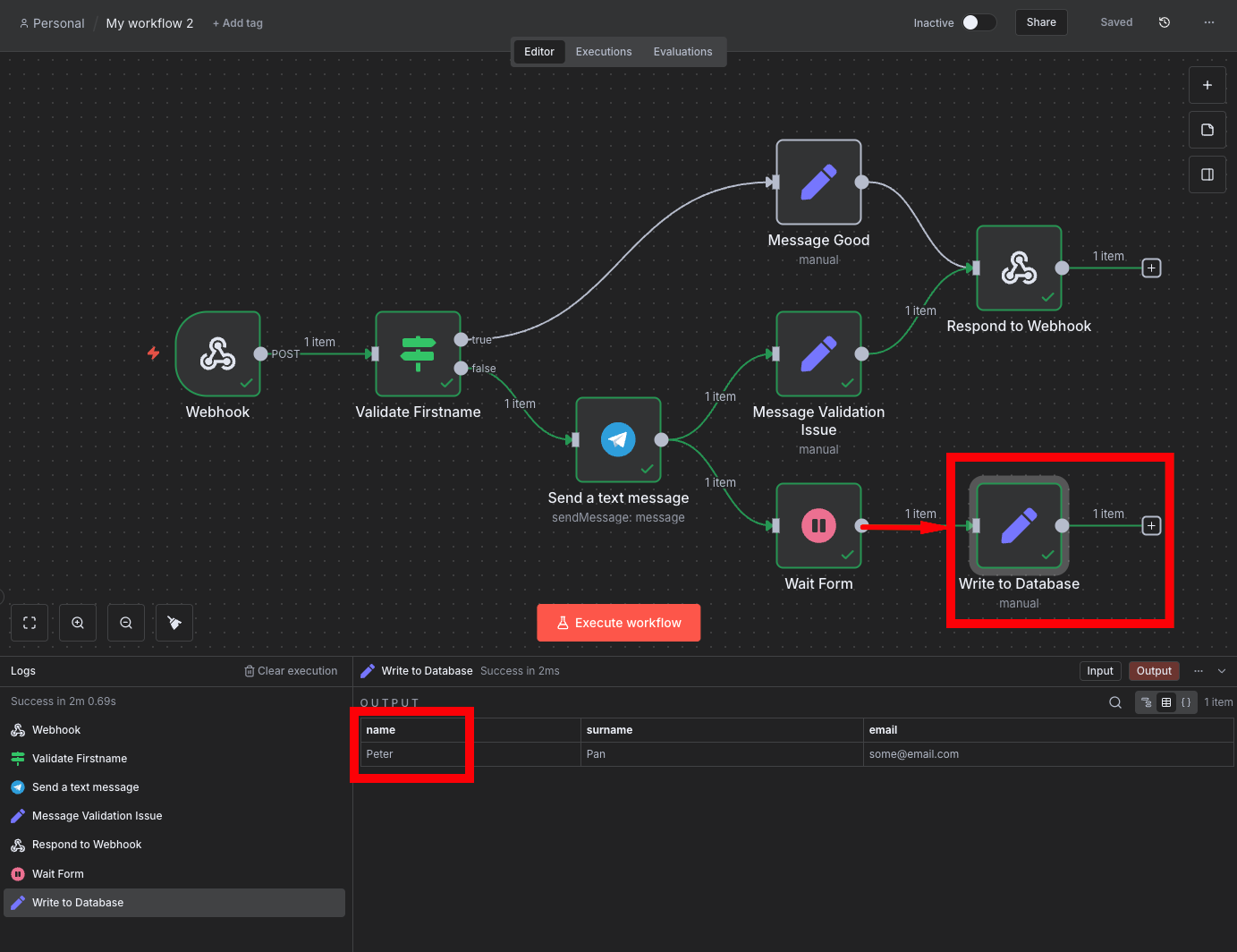

Here is a crude example not knowing what your actual workflow looks like or what your use case is.
  1. webhook submission, if firstname is present everything continues as normal.

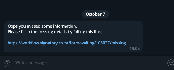

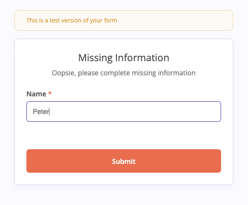

  2. If firstname is missing, we send a message to telegram with a url to the form we want to use to capture the missing fields. For now this is hradcoded to Name, but you can also build a dynamic form based on multiple missing fields.
  3. Once the user clicks the link and fills the form, the workflow continues and builds the complete dataset in the end to do whatever with.
Corrected workflow:
