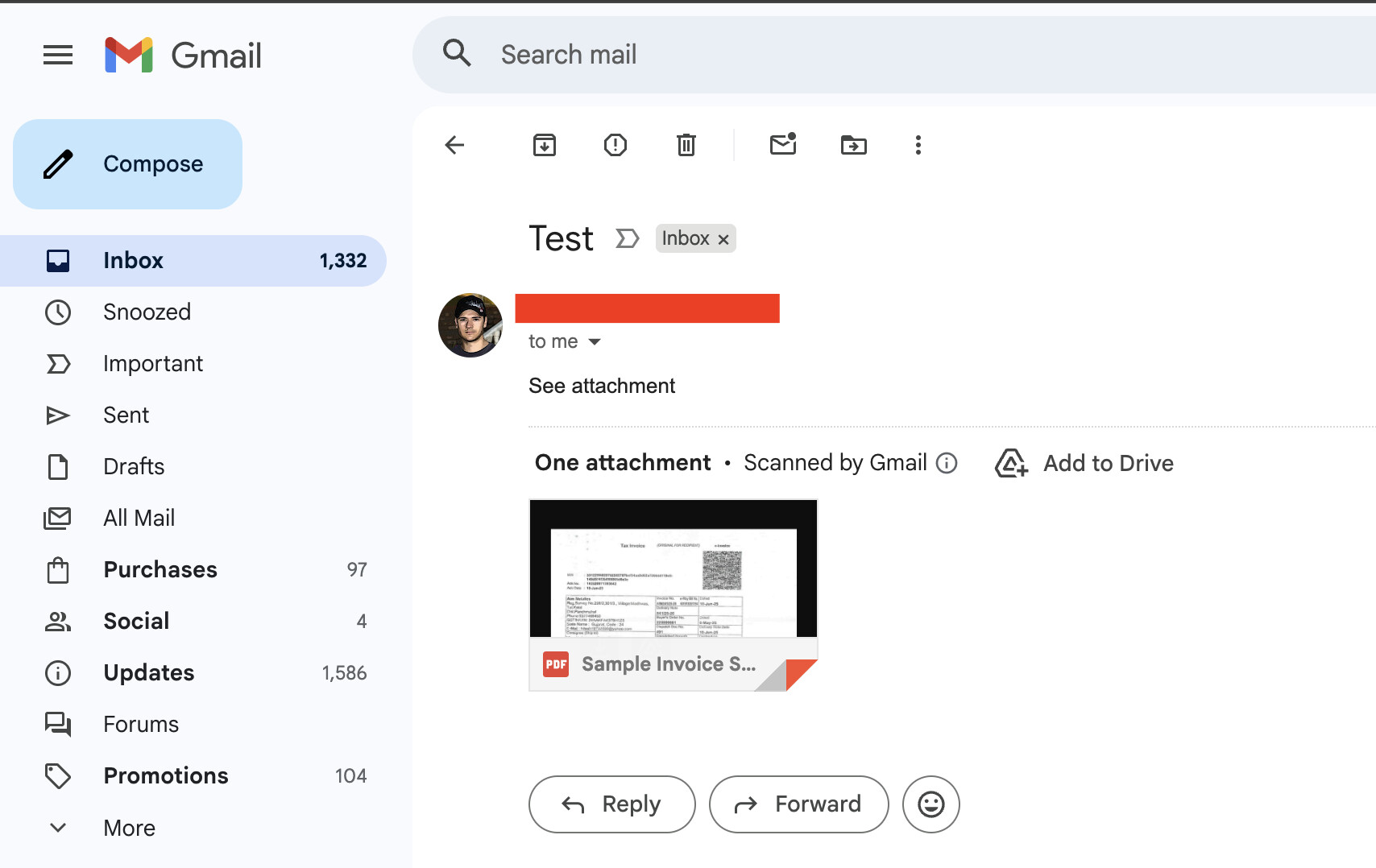

Hi @izadimrantan,
Im not aware of how to pass binary data to an AI Agent tool call directly, but you can try and convert the binary to a base64 string first and then passing that to a sub-workflow tool.
The sub-workflow tool will then reverse the base64 string to a binary again and then send the email.
This example below is very basic and will require some work to support sending multiple files, however I hope this gives you an idea of the direction of thinking I applied.
Main Workflow (Agent):
Sub Workflow (Used as tool):

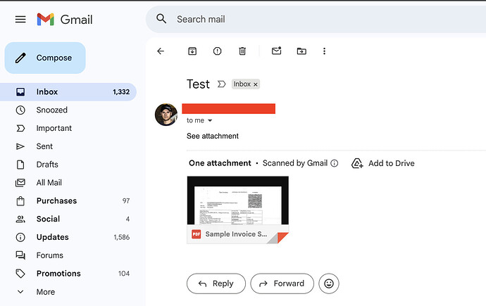

Results:
