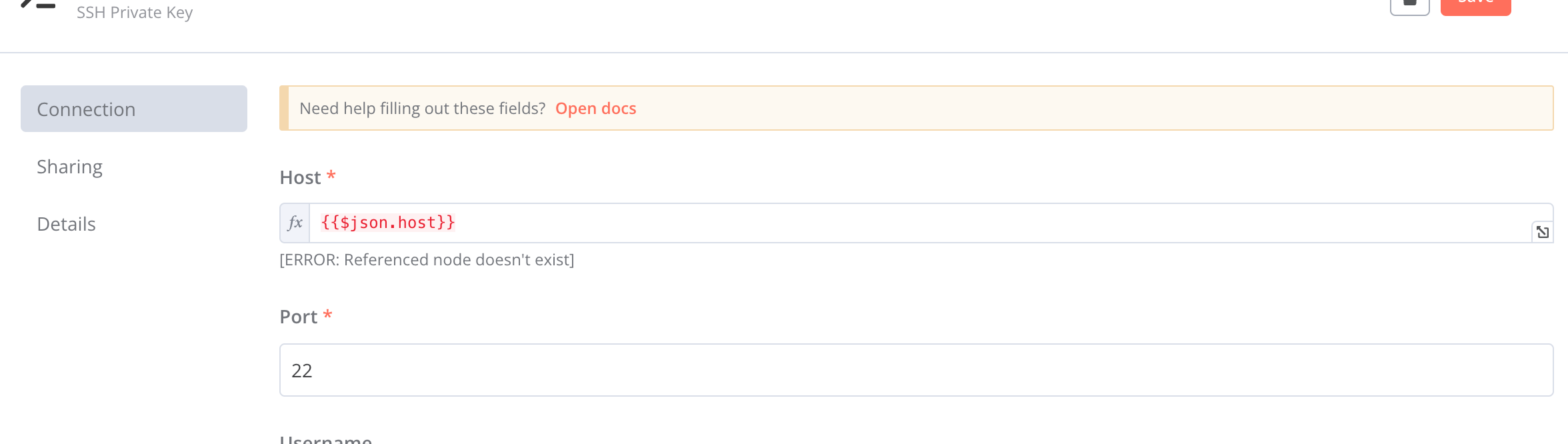

I created an SSH-Credential using {{$json.host}} as an expression for host.
But the expression is not evaluated correctly.
If hardcode an ip inside the credential everything ist working as expected for the single host, so the provided sshkey can’t be the reason it’s not working.
I need to loop over a list of hosts and execute an ssh comannd on each host.
Any Help is greatly appreciated.
Error: All configured authentication methods failed at doNextAuth (/usr/local/lib/node_modules/n8n/node_modules/ssh2/lib/client.js:865:21) at tryNextAuth (/usr/local/lib/node_modules/n8n/node_modules/ssh2/lib/client.js:1082:7) at USERAUTH_FAILURE (/usr/local/lib/node_modules/n8n/node_modules/ssh2/lib/client.js:430:11) at 51 (/usr/local/lib/node_modules/n8n/node_modules/ssh2/lib/protocol/handlers.misc.js:408:16) at Protocol.onPayload (/usr/local/lib/node_modules/n8n/node_modules/ssh2/lib/protocol/Protocol.js:2059:10) at AESGCMDecipherNative.decrypt (/usr/local/lib/node_modules/n8n/node_modules/ssh2/lib/protocol/crypto.js:987:26) at Protocol.parsePacket [as _parse] (/usr/local/lib/node_modules/n8n/node_modules/ssh2/lib/protocol/Protocol.js:2028:25) at Protocol.parse (/usr/local/lib/node_modules/n8n/node_modules/ssh2/lib/protocol/Protocol.js:313:16) at Socket.<anonymous> (/usr/local/lib/node_modules/n8n/node_modules/ssh2/lib/client.js:775:21) at Socket.emit (node:events:518:28)

You can’t use expressions for setting up credentials. If you wish to dynamically generate credentials, you’d have to use a node where you can add the relevant data from the inputs. Not sure if it’s possible for SSH.
If your SSH server supports SSH over HTTPS, you can try using the HTTP request node for this.

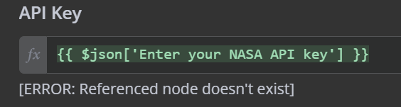

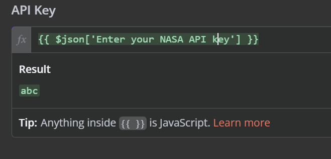

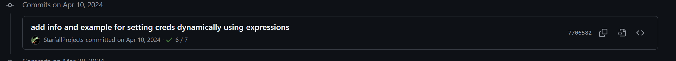

as per docs this should work, this is why i tried it
Sorry, you’re right. As per the doc, it should work. But either the doc or the example is wrong because using that same workflow gives this error:
Referenced node doesn't exist
It shows the value correctly:
yet returns that error. That particular example was added last year:
not sure if something has changed since then.

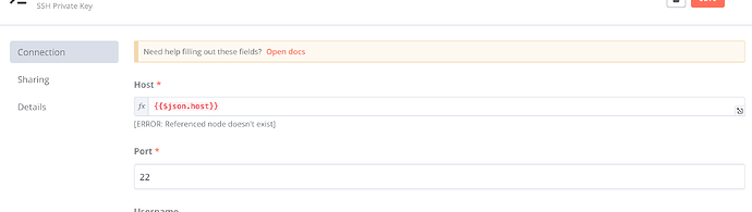

Hi, any progress on this? I would say this is an absolutely essential feature. If I want to send commands to dozens of VMs, it can’t be the solution to add a credential entry for each VM. In my opinion, this makes the SSH functionality close to unusable, already on private environments.
For the Moment i ended Up creating ssh credentials for each VM resulting in a messy Workflow with Lots of ssh nodes. It works but isn`t really maintainable.
Don’t want this discussion to close automatically, but wanted to note that I am trying to accomplish the exact same thing (automate SSH commands to a group of servers).
This is frustrating in the SSH Credential scenario, where you have a key to SSH to multiple hosts and need to automate a task across dozens or even hundreds hosts. Isn’t that the whole point of using dynamic expressions, which appears to be an allowed capability in the SSH Credential’s ‘Host’ field. At the workflow node, it becomes essentially useless because its unreferenced. IMO this is a MAJOR BUG that needs to be fixed.
