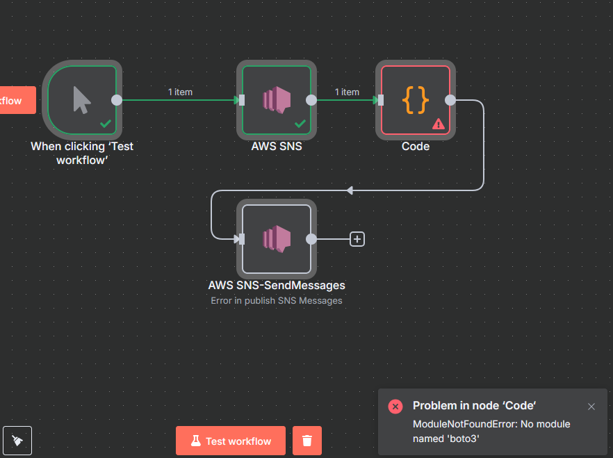

I’m a new user with n8n, and I was testing this tool with a simple workflow.
in my case I receive erros when I use node Code with python language and import module.
I defined the variable that permit using external modules and I was installed the modules in my Dockerfile.
So how can I solve this problem? I searched a lot but nothing solved. I saw about using execute command node, however using a code node is better in my vision.
Here’s my setup:
  • n8n is running in Docker in wsl Linux - Ubuntu.
  • Docker port mapping: 5678:5678
  • Image: latest
  • N8N_VERSION=1.89.2 I tried with latest before
Error detailed:
Stack trace
Error: ModuleNotFoundError: No module named 'boto3'
    at PythonSandbox.getPrettyError (/usr/local/lib/node_modules/n8n/node_modules/n8n-nodes-base/dist/nodes/Code/PythonSandbox.js:91:14)
    at PythonSandbox.runCodeInPython (/usr/local/lib/node_modules/n8n/node_modules/n8n-nodes-base/dist/nodes/Code/PythonSandbox.js:78:18)
    at PythonSandbox.runCodeAllItems (/usr/local/lib/node_modules/n8n/node_modules/n8n-nodes-base/dist/nodes/Code/PythonSandbox.js:49:29)
    at ExecuteContext.execute (/usr/local/lib/node_modules/n8n/node_modules/n8n-nodes-base/dist/nodes/Code/Code.node.js:155:17)
    at WorkflowExecute.runNode (/usr/local/lib/node_modules/n8n/node_modules/n8n-core/dist/execution-engine/workflow-execute.js:681:27)
    at /usr/local/lib/node_modules/n8n/node_modules/n8n-core/dist/execution-engine/workflow-execute.js:915:51
    at /usr/local/lib/node_modules/n8n/node_modules/n8n-core/dist/execution-engine/workflow-execute.js:1246:20
I just saw that python code supports n8n provides Python support using Pyodide, however there is no boto3 here
