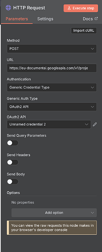

Hello everyone,
I am trying to integrate PDF analysis into an n8n workflow. To do this, I would like to use the Google tool “AI Document”. However, I’m not sure how to approach this, and I’m stuck with the HTTP request. The output should be structured data in JSON format. To do this, the PDF should be uploaded to Google AI Document and then the results returned. I’ve added the first part of the workflow.
Hier noch die Informationen die ich beim HTTP Request eingeben kann:
Error code
404
Full message
Unsupported content type: text/html; charset=utf-8
Request
{ “body”: { “”: “” }, “headers”: { “accept”: “application/json,text/html,application/xhtml+xml,application/xml,text/;q=0.9, image/;q=0.8, /;q=0.7” }, “method”: “POST”, “uri”: “https://eu-documentai.googleapis.com/v1/projects/1066385670266/locations/eu/processors/7759736a6793ab7:process”, “gzip”: true, “rejectUnauthorized”: true, “followRedirect”: true, “resolveWithFullResponse”: true, “followAllRedirects”: true, “timeout”: 300000, “encoding”: null, “json”: false, “useStream”: true }Information on your n8n setup
When reading the API documentation ( Method: processorVersions.process  |  Document AI  |  Google Cloud Documentation ), I would assume that you have to send a JSON body with your request to receive a valid response.
