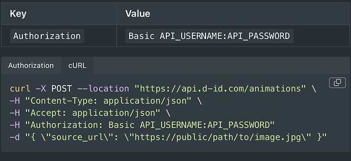

The basic authorization in D-ID is described here:

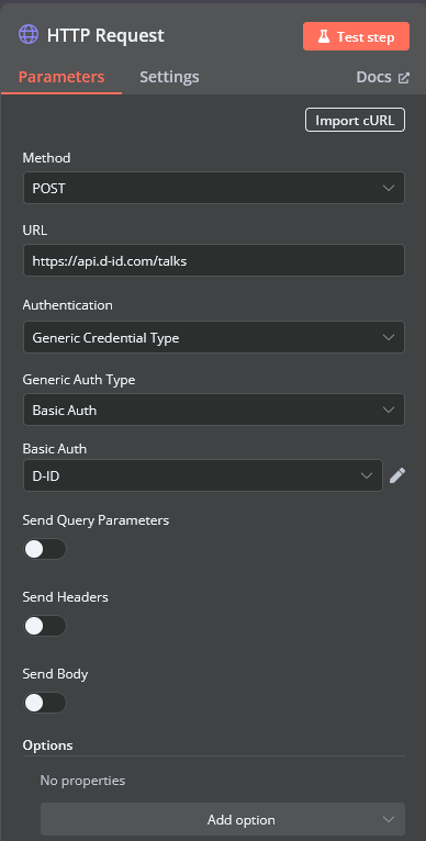

Within the http Request node I think this set up is needed
as I saw in a solved problem here (How to build a Polling Loop?).
I already tried that with the followind credentials:
  • Using my D-ID username as User and the API key as Password
  • Using just the API key as both
  • Using the base64 encrypted version of my API key the same two ways as above
Also tried various forms of sending a header. The one I thought was in line with the documentation of D-ID was:
  • Generic Auth type: Basic Auth
  • Credential with username/password for D-ID
  • Send header, Specify Headers as “using fields below”
  • Header parameters: Name: Authorization / Value: API-key
That fails as well. According to the solved problem of @Sebastian_Irmer in this community that doesn’t seem to be necessary, but I can’t figure out what the D-ID API needs instead.

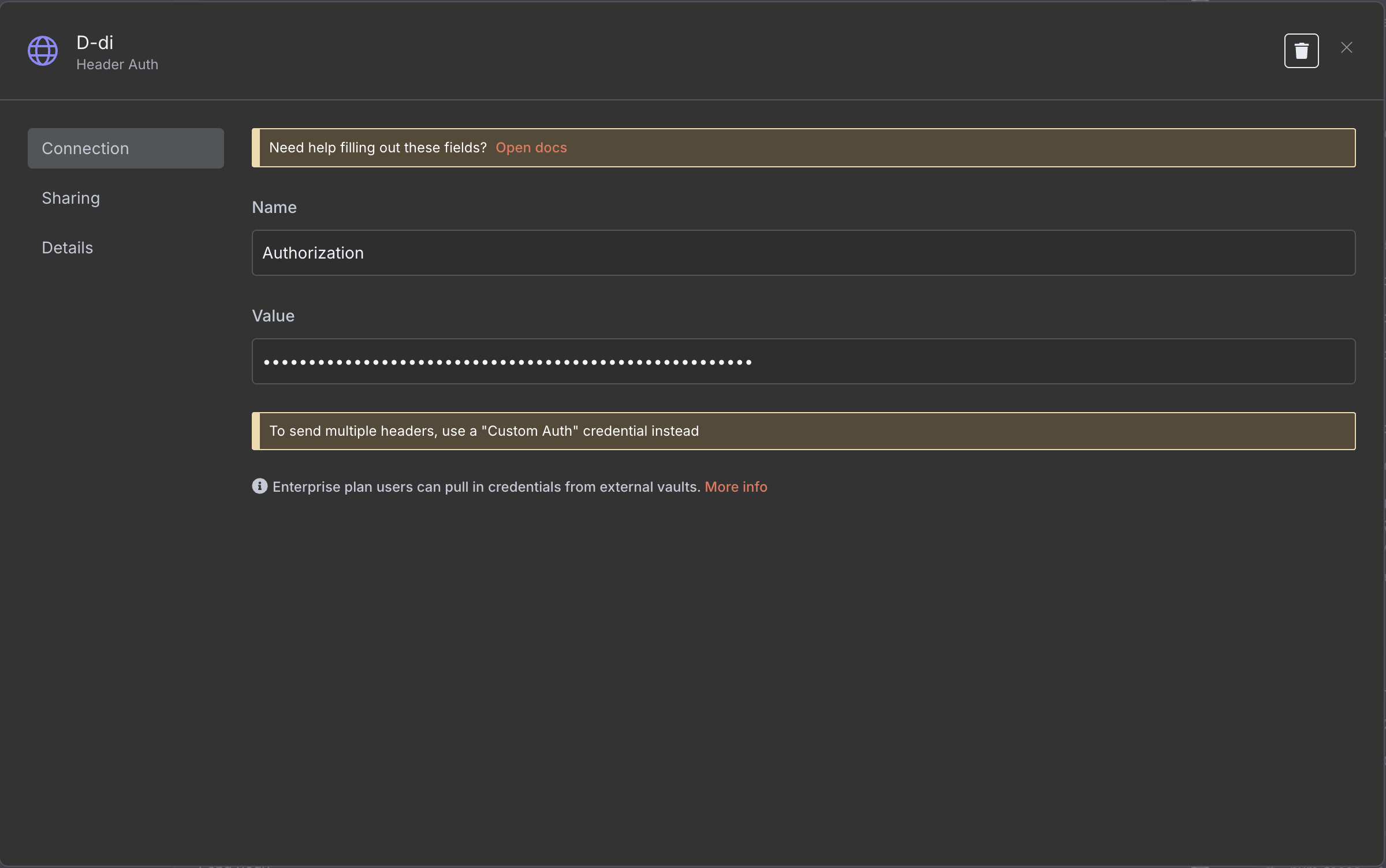

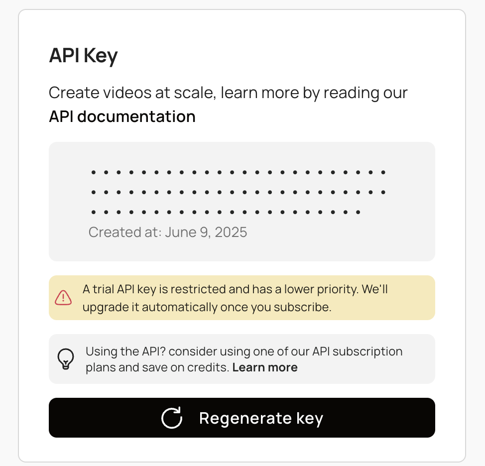

I found their API key document is somehow not matched with current status
Created the API Key in this place.
Let’s say it generated aaaaaa

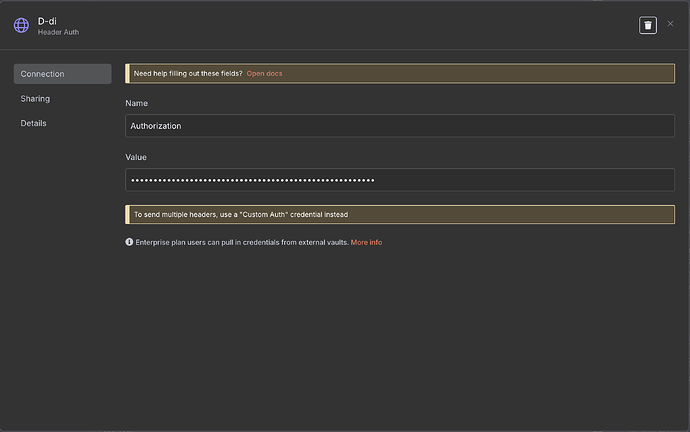

And using n8n header auth with
value : Basic aaaaaa (remembe the space between Basic and key)
This works for me.

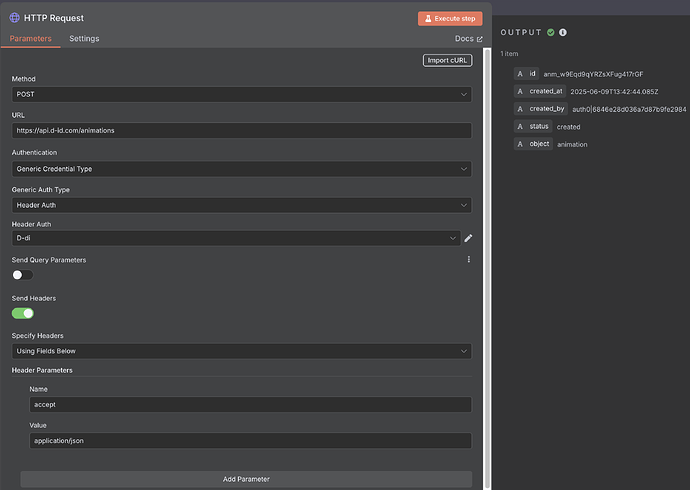

Hi Darrell,
Thanks a lot for your fast answer and working solution!
Interestingly I also made it working with their cURL code now:
This uses regular user/pw as credential but sends the API within the header in contrast to your solution - and works as well. Maybe the point was more the field “Accept: application/json”.
I am somehow still confused but so happy it works. Thanks again for your support!
