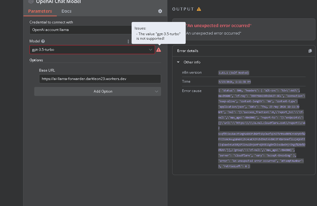

Awesome, am testing but only works for once or two times, then shows
β€œerror”: β€œ500 "An unexpected error occurred"”
thanks
Hey @Daniel_Martin_Leon_S, thanks for your feedback and apologies for my late reply.
Are you using it with an AI agent or with a chain? I ran into this issue several times when using with AI Agent (I mentioned it in the video), but the connection should work fine with chains. If possible, please provide more details about your workflow and I’ll try to investigate further.
Hi, thanks for the reply, am using for separate testings both Ai agent and chat, on the first try it works with simple questions, but on the second send errors and the screenshot issue.
