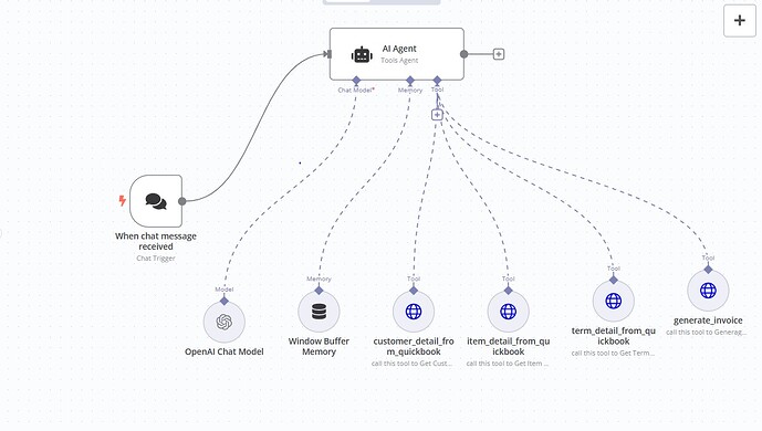

One more thing, I have 4 http tool nodes which are connected with AI agent and 3 of the http request tool nodes responses will be in add to the 4th json body.
Image attached for better understanding,
Josn body of 4th node:

  1. Do you need to preserve all data from previous calls or just specific fields?
Just specific field
I think this should solve your problem of just sending one data to the AI Agent,
