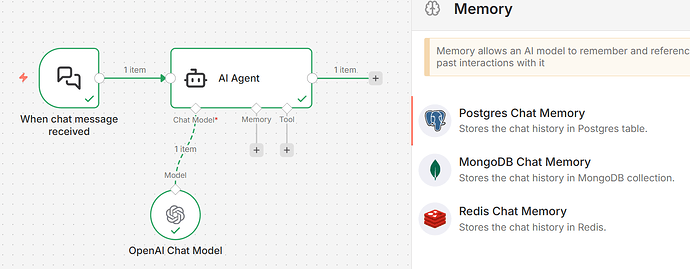

We have N8N Self Hosted using queues, we recently upgrades to version 2.4.8. We are heavily using AI related nodes. After the update we notice that SImple Memory node is gone (not showing in the list of Agent Node when you choose Memory. Reading the docs it seems now Simple Memory Node is not supported when using queues. We built a lot on top of it and I would like to know if you are working on a short-term solution to have Simple Memory back or understand alternatives.
Normal workflow errors since Simple Memory is not showing anymore
It happens with any workflow that uses AI Agent Node and try to add Simple Memory.

I recommend restarting your n8n instance and using an incognito tab, ‘Simple Memory’ exists so just restart your instance this would solve the issue.

The best alternative is the Postgres Chat Memory node. Since you already have Postgres configured, this is the intended solution for your setup and will allow you to persist the memory correctly.
