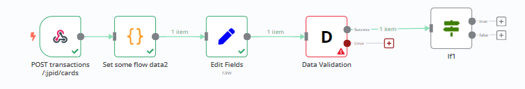

Specifically I want to understand how to process the result when the JSON does not match the Schema, and how I grab and use the error message in subsequent nodes.
I have tried various settings for “On Error” but I can’t get any data into the following node

thanks, the node settings are just a JSON Scheme I am using to test this node’s functionality, so I just have a schema like

If I expiryMonth’s min and max to 1 & 12 then my JOSN Validates as expected and my output is
    "HashedPAN": "Visa***1199",
    "ExpiryYear": 2028,
    "ExpiryMonth": 3
and nothing gets sent to the Error Branch.
But if my JSON does not validate against the Schema, then this node throws an NodeAPIError() and I see and Invalid Data error like the one above.

Not sure if the 400 error is by design or not.
Is there a way to catch Node errors like this and inspect the data? I could use the “message” in the thrown error.
Ahh I see, that is not how I would have designed it.
If the error returned doesn’t show the complete error in the data returned there is nothing you can do about it I think.
So it would need to be changed in the node itself to pass this message properly.
thanks. Looks like I need to fork the node to fix this
