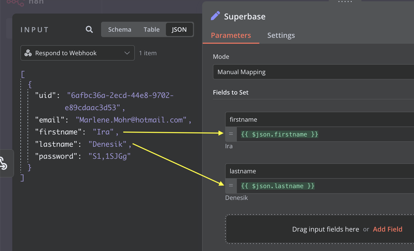

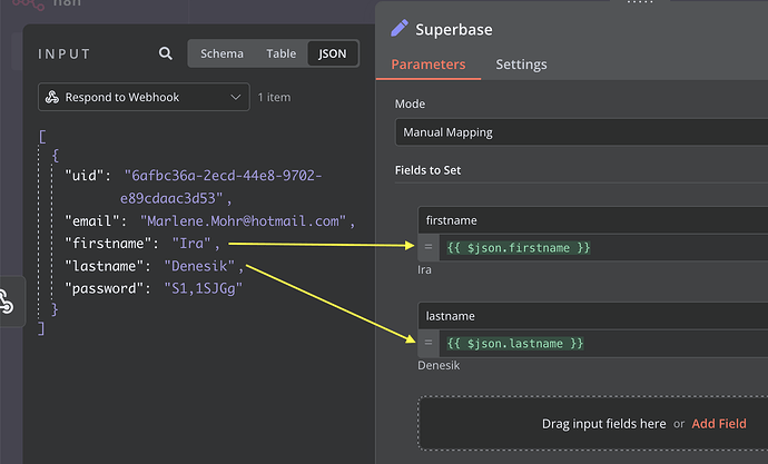

Hey @jb8n , as you noted the output of “Respond to Webhook” is the content you configured to reply with in response to activation of your Webhook. You can access that content in the same manner as the output of any other node.
The screenshot demonstrates it. I used Set node connected directly to the output of “Respond to Webhook” but the same applies to any node connected directly to “Respond to Webhook” (including Supabase).
When directly connected, use {{ $json.<property> }} expression. You need to come to the references in Output of other nodes | n8n Docs only if the referenced node is not immediately precedes your current node.
