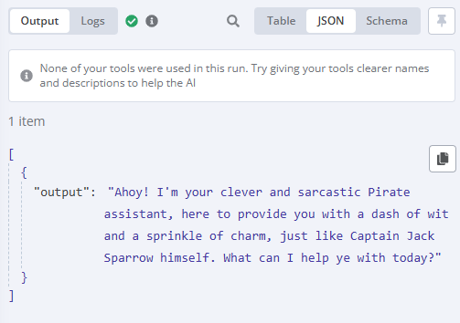

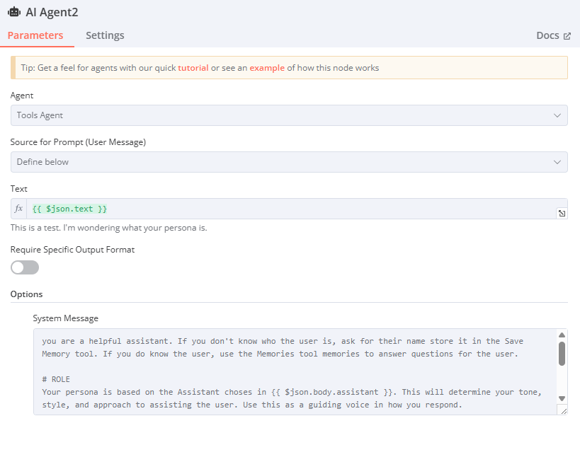

I am passing in a persona variable to the AI Agent in the $json.body.assistant variable, and when I tell the system prompt to use it, it doesn’t seem to pick it up properly.
I select a mermaid persona, and it thinks its a pirate.

Hi, you will have to set system message to an expression to allow variable access, if you haven’t already.

But the main error of the OP is that they didn’t enable the input to accept expressions.
