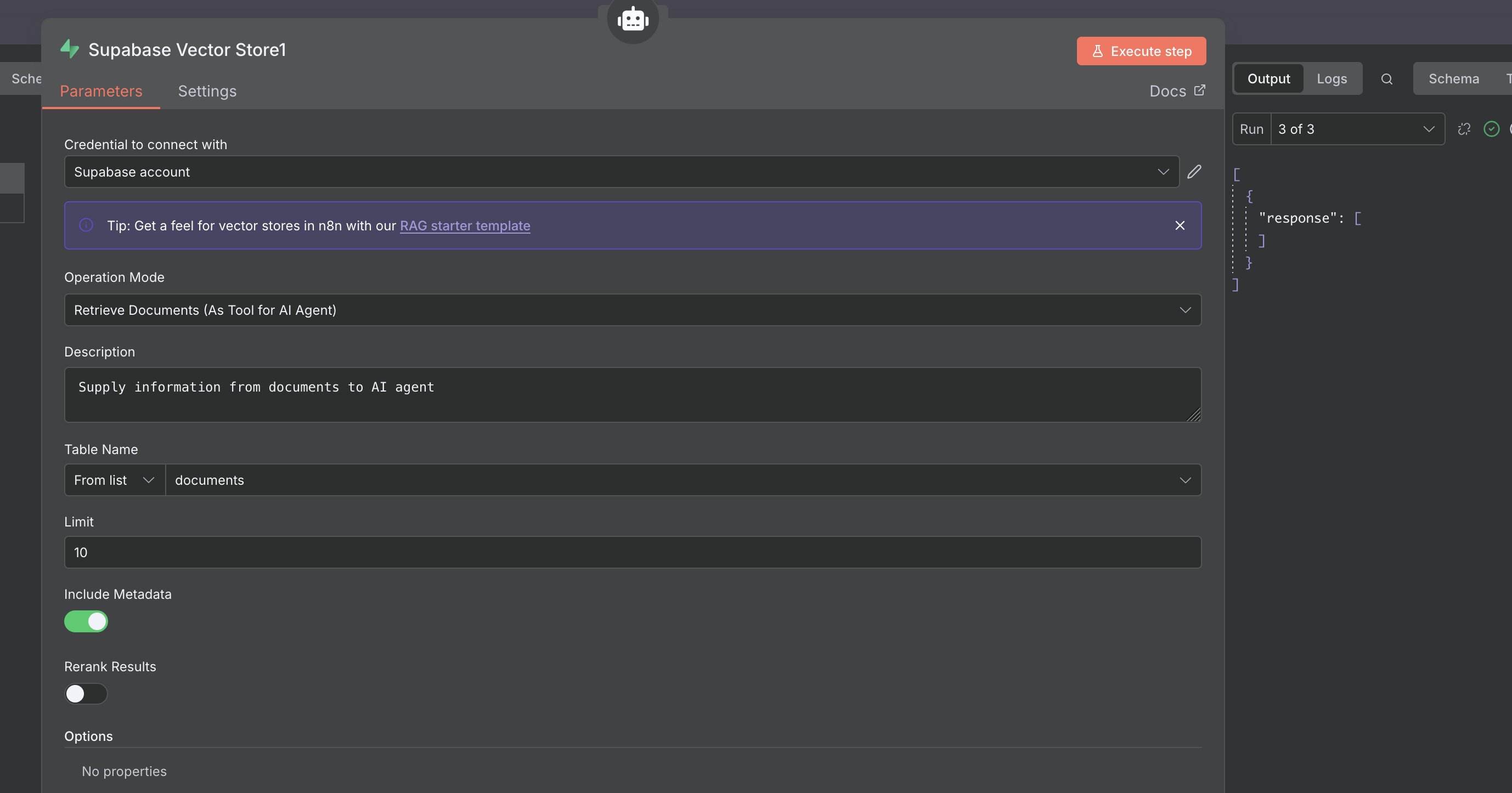

Supabase node showing empty output response

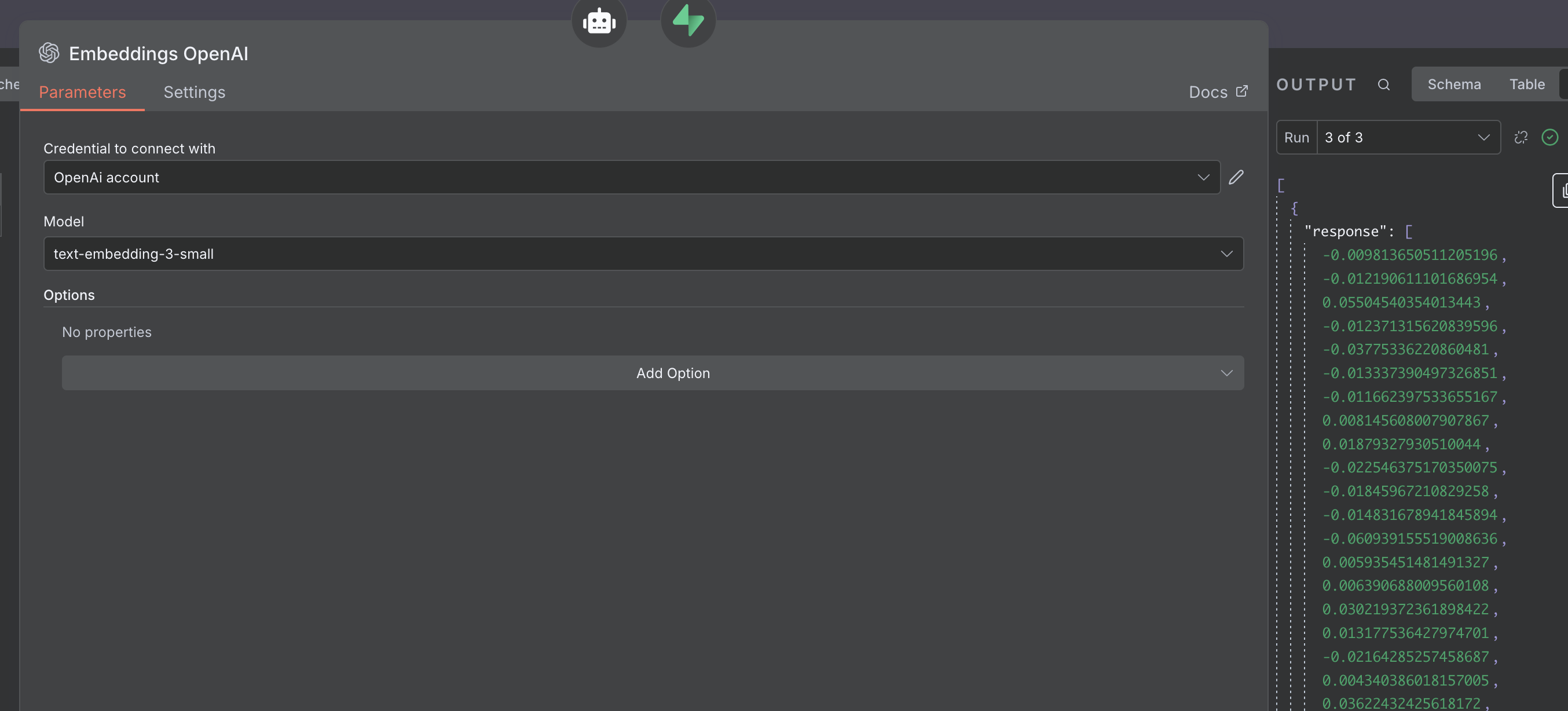

Connected EmbeddingsOpenAI node output with vectors.
