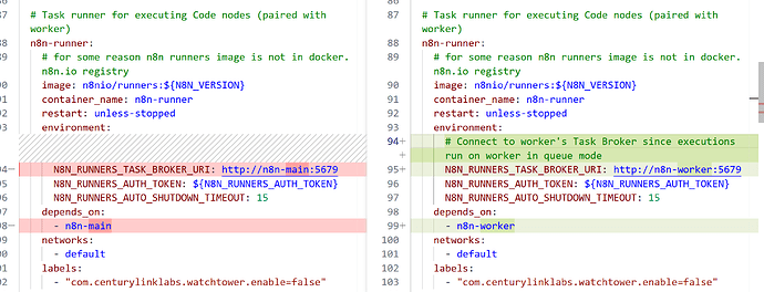

If you have configured OFFLOAD_MANUAL_EXECUTIONS_TO_WORKERS to true, then make sure the runner container is connecting to the worker container not the main container
