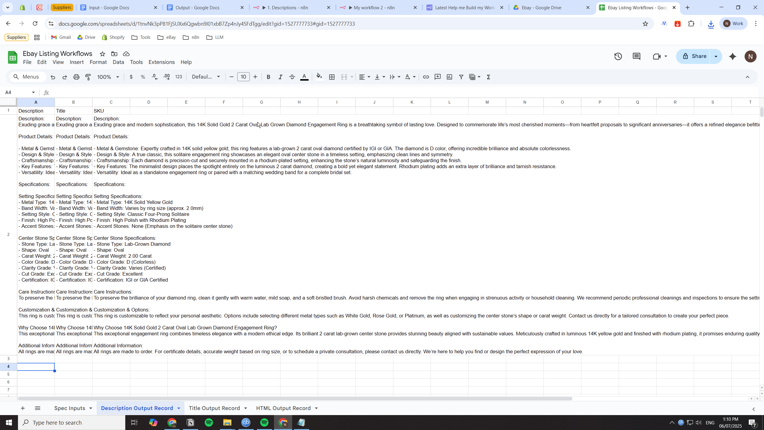

Basically, I am passing data from 3 agents (Product SKU, Title, Description AI Agents generators) to a set node and then onto a spreadsheet. I need the data to be in the same row.
However the output to the sheet isn’t working, it only pastes in descriptions, and excludes the title and SKU.

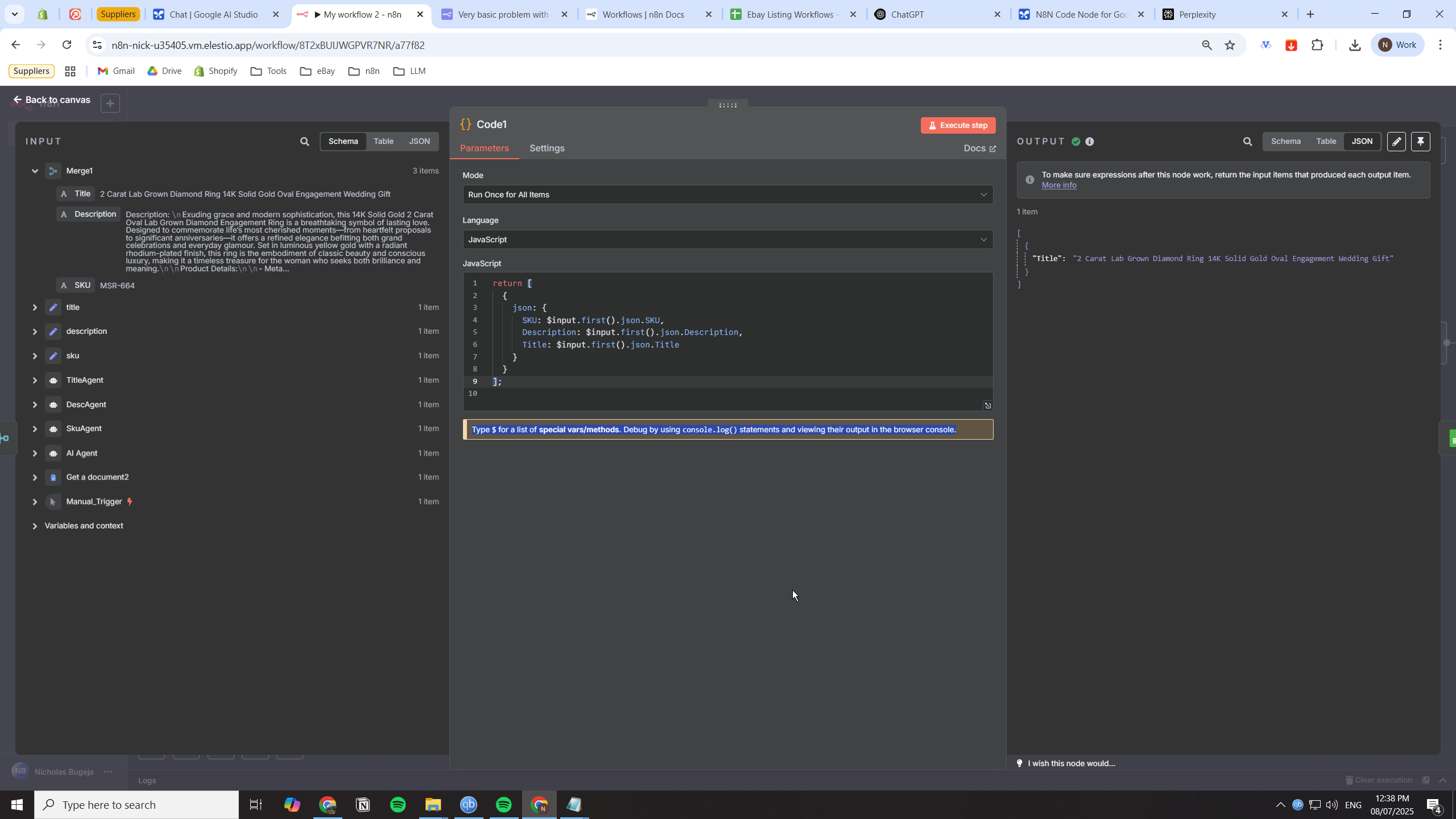

Hey Theo, thank you so much for the help, it worked, but I ran into another minor problem if you don’t mind me asking please.
Basically, the newly added code node is only outputting the Title field for some reason, which makes no sense.
@Nick_B
Glad I helped, but you still have an issue because you didn’t merge as I suggested :wink:
You’ve selected “append” method in the merge node, meaning all items are appened resulting in 3 items. Then you’re requesting in the code node the 1st item each time. With 3 items triggering the code node, you’re requesting 3 times the 1st item. Since you have only the title in the 1st item, at the end you’re getting 3 times the Title from the 1st item :sweat_smile:
Use the “combine” method with “by position” parameter and 3 inputs, each plugged to each agent, and it should work.
Then you don’t need the code node anymore!
Let me know if it works!
