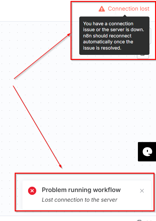

When i open n8n I see this error and can not run my automations:
I already tried several different configs found on the forum but nothing helped so far. Also tried to downgrade → Same. It probably has something to do with nginx but I’m not sure how to dig deeper.
