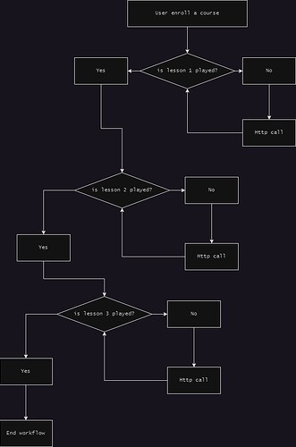

Here is the scenario that I want to happen for a user.
I have a course on my site and if a user finishes each lesson, a webhook can be called.
There are 3 lessons and I want to ensure users are reminded to watch each lesson.
