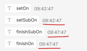

Just tested on v2.13.4 (cloud) and v2.9.4 (self-hosted) and didn’t get the issue. My main WF went to the waiting state until the sub WF is completed.
main WF:
sub WF

Can you share the workflow? For me, it works fine with one item
what do you mean by one item? I literally have only a schedule trigger that calls my sub-workflow and that’s all…
I have the same problem. I have four different routes in my main workflow, but the routes are processed one by one, starting from the first. It’s a waste of time that there’s no parallelism when “Wait For Sub-Workflow Completion” is disabled, because when I turn that option off, the data passes through without being processed.
I mean that I have to call the sub workflow with only one item in the input.
And the example from this post is working fine with it
