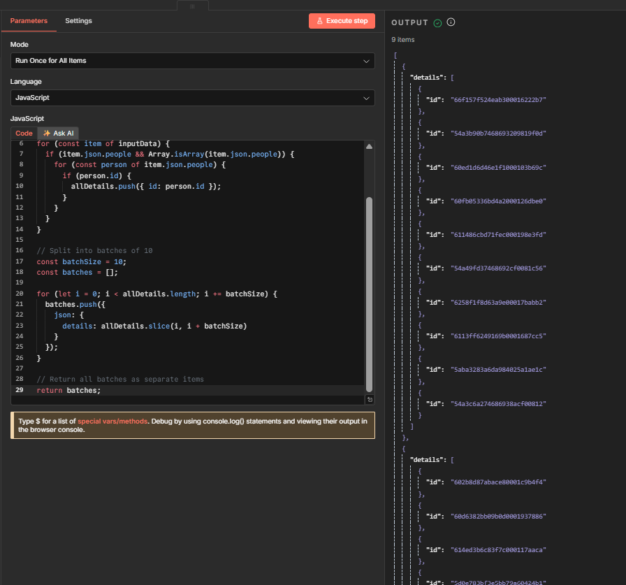

I have a code node before that formats the IDs in batches of 10, each batch being an item.

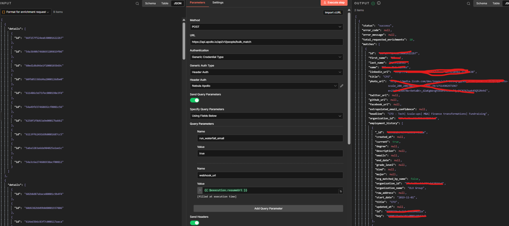

The HTTP node runs successfully for each item (batch), and returns the results.

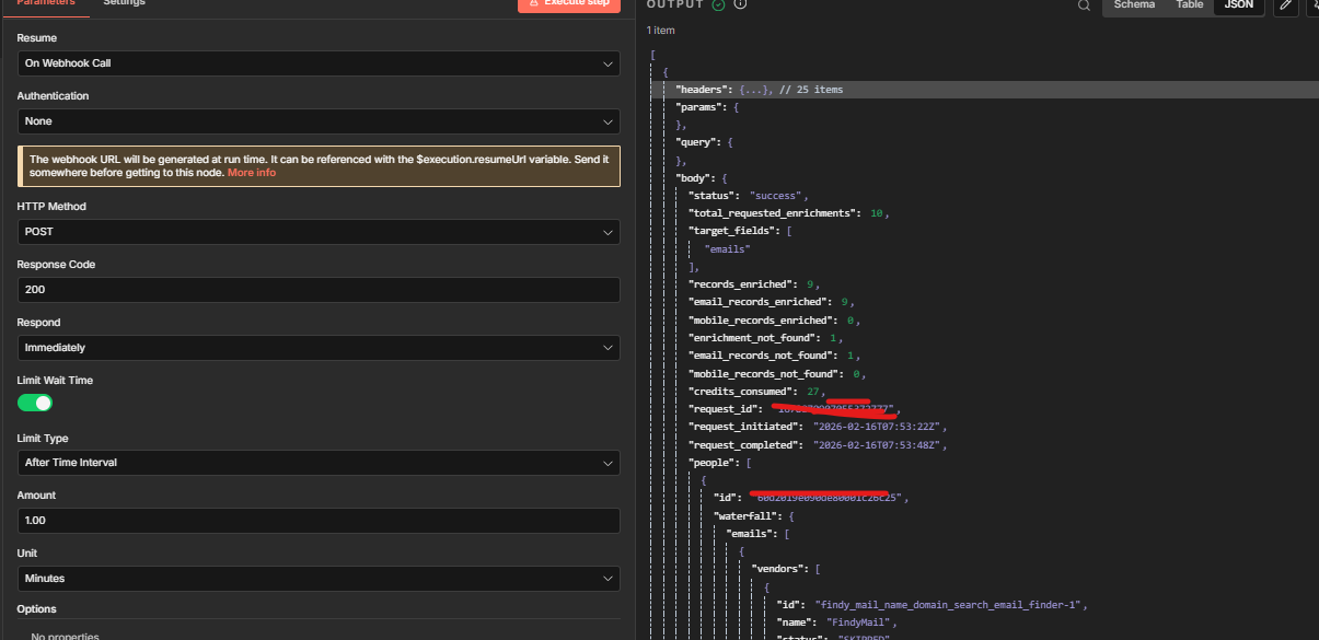

Unfortunately, to get a contact’s email, the response comes via a webhook. I have set the webhook in the HTTP node as {{ $execution.resumeUrl }}, and have a wait on webhook node after to get the emails.
The problem currently is that the flow resumes after the first batch’s emails are returned, and the rest are ignored (never come through). I have checked the executions and it does not create a separate execution for the second batch.

Formatting batches:
HTTP request:
Webhook for emails: (as seen there is only 1 item)

you need to process them sequentially. Add a Loop Over Items (or Split In Batches set to 1) after your Code node. Put your HTTP Request and Wait nodes inside this loop.
This forces the workflow to send Batch 1, pause until it gets that specific answer, and only then loop back to send Batch 2.
