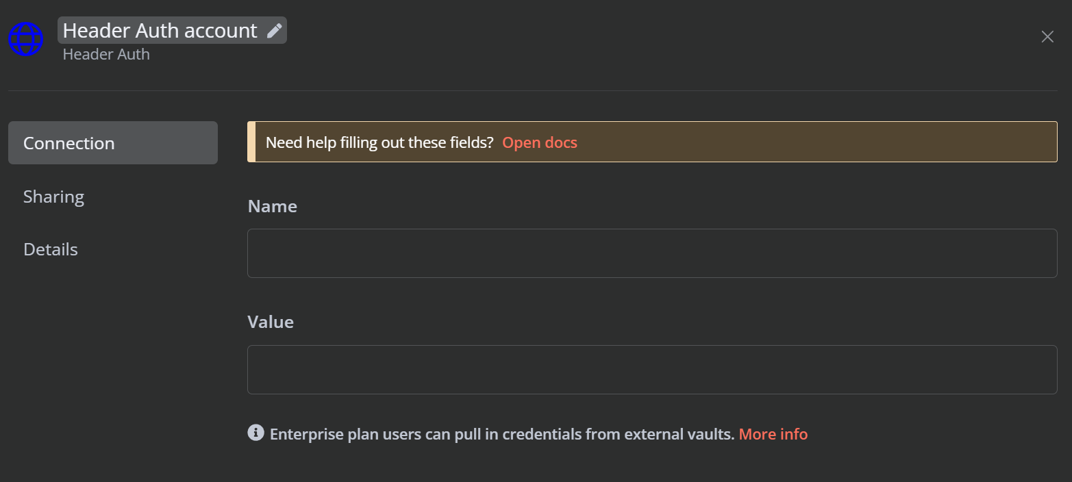

Secondly tell me about Header Auth.
Do I just choose any secret name value pair and send it from the form?

About header (or other auth method), you can read more here but you just create credential, and set it to webhook, after this n8n will handle authentication (if passed correct then work otherwise return 403 error)
