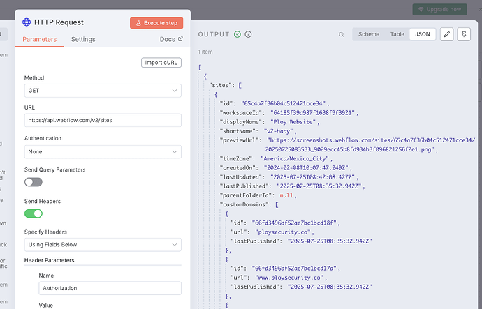

To validate the gaslighting in n8n (lol) I created a http request with the header having my api token in, which successfully returned data about our webflow instance.

Any way you still can use generic auth → header auth
Paste the Authorization to name
Key to value.
So you can use as normal credential.

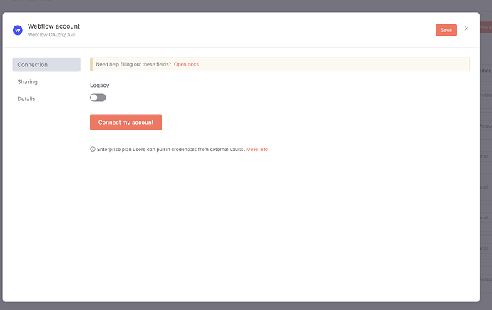

Thanks darrell_tw that would definitely work. However, I have figured it out. Webflow now only uses the Oauth2 API to connect… which defaults to have a toggle automatically go to legacy. This then doesn’t work and also doesn’t give you the required permissions.
So if legacy is de-selected (unusual that it defaults to this) it all then works in the node.
