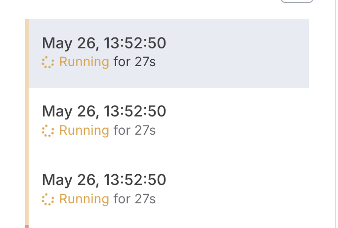

I’ve created a workflow that uses the Webflow “Item created” trigger. When an item is created, the trigger is triggered three times at the same time, resulting in three parallel executions. Using the “Remove duplicates from previous executions” does not work.
I’m not getting an error, but I see three executions in the executions tab.
