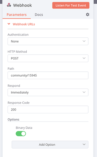

I have just given this a bash and I can kind of see the issue you are having, When Binary Property is set instead of getting
You are getting
When you set Binary Property on the webhook it will replace the field names which is by design for those that don’t need to know the field names.
Name of the binary property to write the data of the received file to. If the data gets received via “Form-Data Multipart” it will be the prefix and a number starting with 0 will be attached to it.
It sounds like to solve this issue just removing that option will do the job, So your Webhook node would just need to be
This then results in what you are after.
If I have missed anything let me know.
Oh wauw, I feel like a complete idiot now…
Thanks! This works!
The toggle ‘binary data’ and it’s helper text Whether the webhook will receive binary data doesn’t do what it claims to be doing though…
