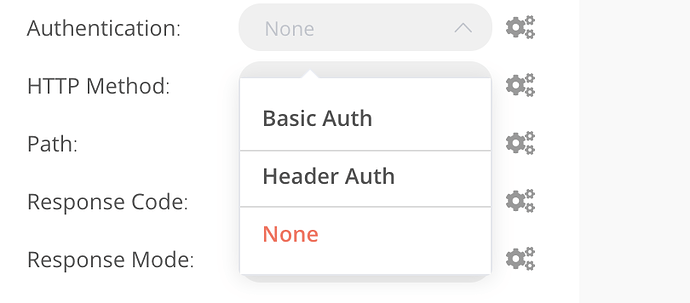

On the “Webhook Creating Endpoints Part 2” video on YouTube, a proper way to authenticate users is mentioned but not described. What is the proper way to secure Webhooks on n8n?
You can use either header authentication or basic authentication
