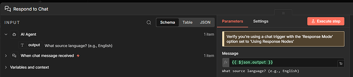

The AI agent outputs the question and I want it to be forwarded to the chat.
Even though I set the Using response nodes the warning remains and the node goes into continuous thinking state.
This also occurs if I create a new workflow with only having “when chat message received’ trigger and connect it to a Respond to chat with some sample answer. (It should spam that back regardless of what I type in)
