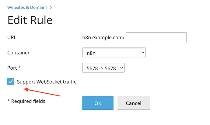

Old topic, but I faced the same problems.
In Plesk, make sure to enable web socket traffic in the Docker Proxy rule:
This results in the following nginx.conf
#extension docker begin
        location ~ ^/.* {
                proxy_pass http://0.0.0.0:5678;
                proxy_set_header Host              $host;
                proxy_set_header X-Real-IP         $remote_addr;
                proxy_set_header X-Forwarded-For   $proxy_add_x_forwarded_for;
                proxy_set_header X-Forwarded-Proto $scheme;
                proxy_set_header Upgrade $http_upgrade;
                proxy_set_header Connection "upgrade";
                proxy_http_version 1.1;
        #extension docker end
The last 3 lines were added when enabling web sockets.
With that it works for me (latest n8n = 1.102.4)
Before that I had
  • connection problem error so there was no save button
  • workflows never ended but stuck in “Executing workflow”.
