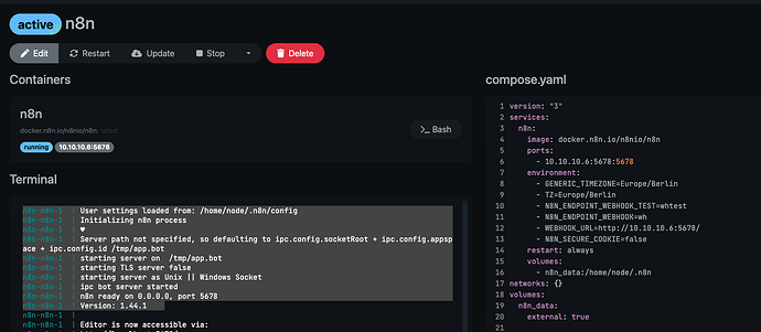

I’m also attaching a few pictures from my docker (dockge) setup and the error it self.

- **n8n version:** 1.44.1
- **Database (default: SQLite):** default
- **n8n EXECUTIONS_PROCESS setting (default: own, main):**
- **Running n8n via (Docker, npm, n8n cloud, desktop app):** docker
- **Operating system:**Ubuntu server 22.04

No, before the manual cfg of webhook URL I did not have any issues. But If I recall correctly it used to work with this custom URL as well.
I tried to reset the config to default settings and I’m still having a problem. n8n gets the trigger when I open the GET url link, but it then results to this error…

To expand my comment from earlier regarding the Cloudflared proxy tunnel vs local access, I get the same error “Internal Server Error”, but also learned that the Web UI is no longer accessible via my Tailscale config (since it doesn’t have SSL cert configured) and N8N_SECURE_COOKIE env variable is new to me!
Hi, sorry for the very delayed reply.
When I saw the words "major bug :exploding_head: " I started migrating everything to a new server.
I came back to the old instance a few days ago, updated everything, and now the issues are completely gone.
Don’t really know what it was, but i have a huge list of custom nodes.
