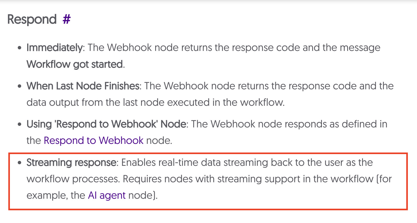

I reviewed the docs and community posts and primarily tried the “streaming response” approach without success.
  • In the Webhook node configuration, I set the “Response Mode” to “Stream”.
  • In a following Function node, I tried the following code, but the caller did not receive these messages in real-time. Instead, they either timed out or received all messages only after the entire workflow finished.
Hi @life_voluptuous,
You have one of four options:
  1. Callback a webhook on the calling end with status updates
  2. Use a realtime db like Supabase or Firebase/Firestore or Redis to write updates to a table/collection, which your originator listens to.
  3. Use websockets to push messages for updates.
  4. Implement pub/sub or event driven architecture using something like Kafka or RabbitMQ
For option 3, you can have a look at the below post:
PS: The Streaming Response is only compatible with streaming enabled nodes such as the AI Agent
