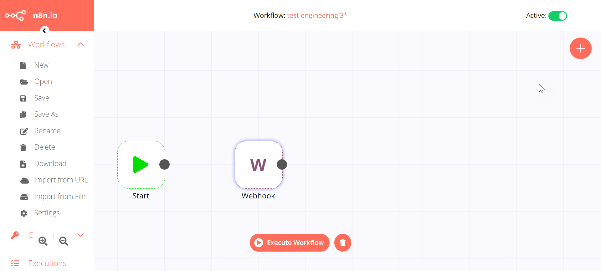

In fact, as soon as I connect my webhook to the prospectin service, I receive in my power shell :
“ERROR RESPONSE
ResponseError: The requested webhook “POST PATH” is not registered”.
I did not trigger an action, it is really when connecting to the service that the error occurs.

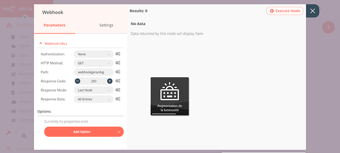

Moreover, I notice that my HTTP Method is Get while POST is indicated in the error.
Then I guess that is the problem. If n8n says that the “POST” route is not registered you are making not a GET request you (or more the service), actually makes “POST” request.
If you have to listen to both GET & POST, you can simply create a second webhook-node with the same path but a different method selected.
Depending on the service you are using, it is possible that they do a kind of pre-check before they register a webhook. They are very many examples which for example send the data via POST but make first a GET request before properly registering a new webhook. Have never seen the other way around (which seems to be the case here send data via GET but make a POST check, and seems honestly very strange) but that does not mean that it does not exist.
