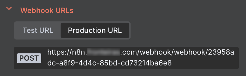

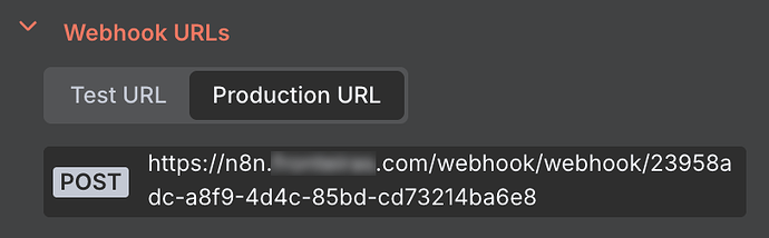

  • Webhook node shows something like:
    https://n8n.domain.com/webhook/webhook/...

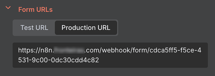

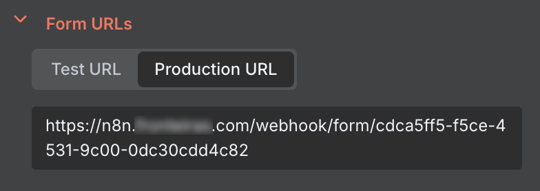

  • Form node shows:
    https://n8n.domain.com/webhook/form/...

As you suggested, here are the screenshots showing the webhook URL issue, plus the content of my docker-compose.yml below.
Webhooks:
Forms:

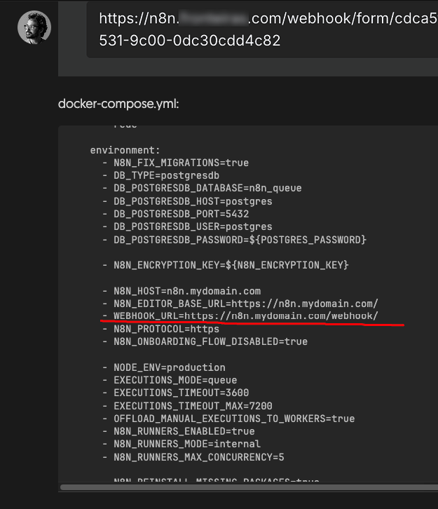

docker-compose.yml:

As suspected WEBHOOK_URL has a /webhook in it
Remove webhook/ from it, it needn’t have it. Then restart.
