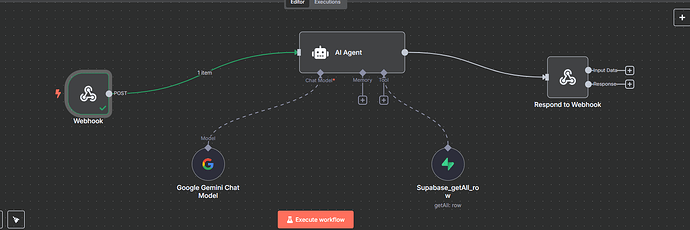

The Problem:
When I call the production URL of my active workflow , the execution log shows that only the Webhook node runs successfully (“Success in 1ms”). The rest of the workflow (the AI Agent and Respond to Webhook nodes) does not execute at all.
My frontend receives an empty response, which causes a client-side error (Unexpected end of JSON input), because it’s expecting a JSON object with the AI’s answer.
My Workflow Structure:
The workflow is set up as follows:
Webhook → AI Agent → Respond to Webhook
Webhook Node Configuration:
  • HTTP Method: POST
  • Response Mode: Using ‘Respond to Webhook’ Node (I have explicitly set this).
  • Path: bott
What I’ve Tried:
  1. Production URL & Active Workflow: I have confirmed that I am calling the production URL (not the test URL) and that the workflow is active .
  2. Simplified Test Workflow: I created a minimal test workflow: Webhook → Set → Respond to Webhook. This simple workflow exhibits the exact same problem : only the Webhook node executes, and an empty response is sent. This seems to indicate the issue is not with the AI Agent node itself.
