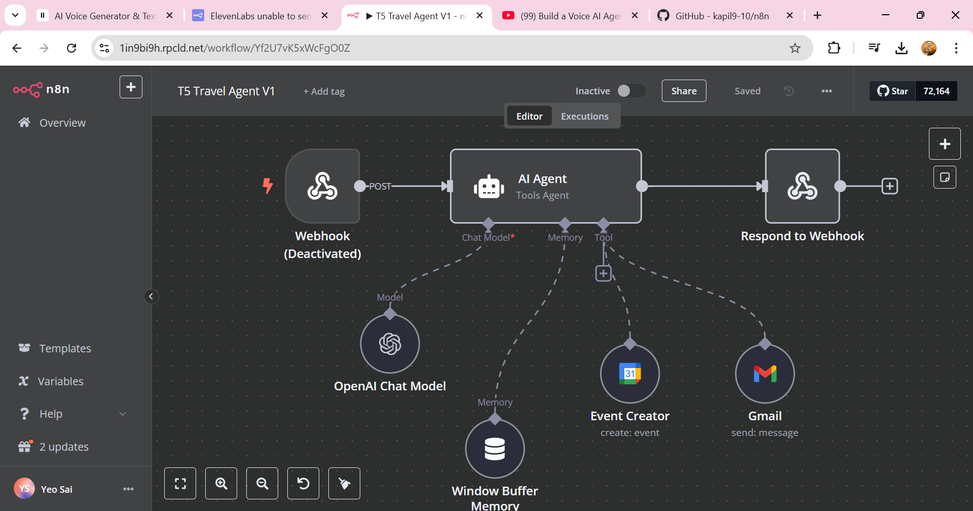

Hi All
Last night I made a below post ,
@Olek You are right , now is working .
I manage to get the out put. : -
[output]
After my workflow terminated with Response to webhook : -
[workflow end with webhook]
Thank you for your help. Now i know Elevenlabs is able to send data to my n8n.
Paul
I learn that in order to received data from ElevenLabs, my workflow must end with Response to Webhook module. Otherwise it will not be able to received data from ElevenLabs.
In the workflow develop by Alessaendro , he does not include Response to Webhook module ,
why it still able to work ? Hope some one can share with me.
Paul
Your webhook has a few options on when to respond:
immediately
when last node is executed
using Respond to Webhook
You can choose those settings in your Webhook Trigger node.
If my reply answers your question please remember to mark it as the solution
Reading thru your discussion referenced. That is because you set the Webhook Respond method to âUsing âRespond to Webhookâ nodeâ.
I do not believe you need this option, and you can use the âimmediatelyâ option instead.
@ThinkBot @solomon
Thank you very for your sharing . I will explore more other option.
