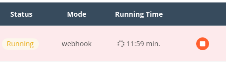

In the GUI executions list I can see it got started but it never stops running:
Please share the workflow
It happens with every workflow triggered by a webhook, if I Stop the execution it figures a 0 seconds runtime, so I guess is regardles of the workflow.

Sorry to hear that you have problems. Can you please share a little bit more about your setup. Like do you use separate n8n instances for incoming webhooks? Did you also start worker nodes? What database are you using? What environment variables did you set for all the different n8n instances?
Hi jan thanks.
I’m using only one n8n instance, and I didn’t start any worker, maybe theres the issue, does the main instance not work as a worker?

I’ll try setting up a worker
Yep that was it I missed that part, thanks a lot @jan!
Ah perfect, yes only the workers run production executions. If you do not have any running then this jobs will stay in the queue indefinitely.
