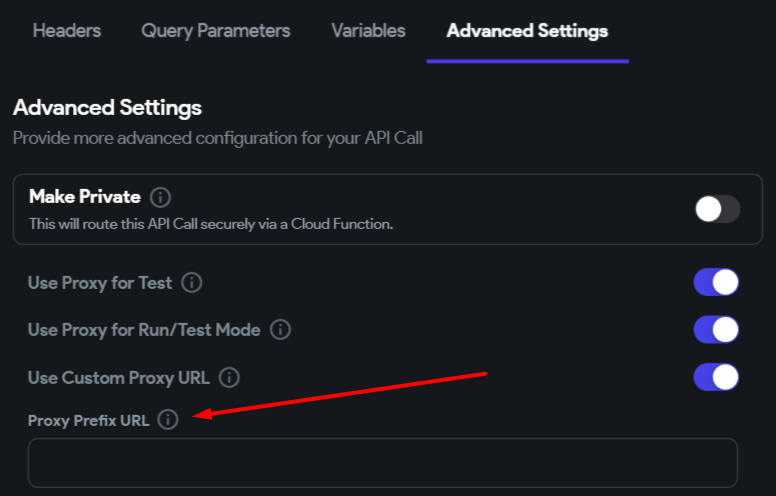

@Jon Thank you. If I get you correctly, I need to add some URL here in API Call settings:
I no nothing about proxy URLs. Do I need to get this URL somewhere in n8n or from some 3rd party?

It would normally be something your reverse proxy to your n8n instance would add.
@Jon I’m not sure if I can find this proxy thing in my n8n instance…
