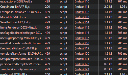

The backend starts up but when accessing the site some of the javascript components come back with a 429 status code

Found the issue.
I investigated the status code 429 which the site was getting and increased the rate limit on the reverse proxy to a more suitable number for the n8n site
