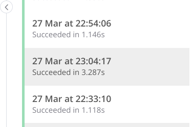

Visually the execution ‘Webhook Wait’ still waits after the restart, my test flow scheduled a check every minute, and so it’s easy to see from below that I left my n8n instance down for approx 19 mins
Before the n8n down time, I had the executions screen displayed and so I received these ‘Problem loading data’ during the down time, as expected.
And after the n8n instance was started the ‘Problem’ messages disappeared and was again left with the expected ‘This execution hasn’t finished yet’
After which the webhook still responded/reached its set timeout response limit of 30 minutes and then continued the flow to the finish, though I probably need to understand / figure out the ‘Succeed in 3.287s’ - I’m guessing that’s movement time in the flow and not elapsed time inclusive of ‘waiting on webhook response’
