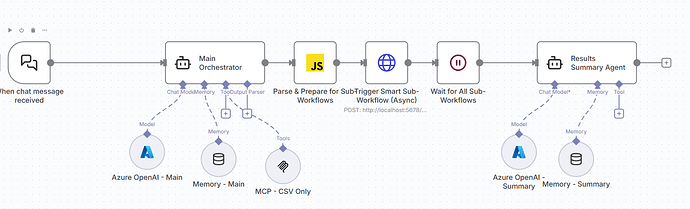

**Main Workflow:**
1. Triggers N sub-workflows via HTTP Request node with `Execute Once: false`
2. Passes the total count of sub-workflows (e.g., 100) to each sub-workflow
3. Uses a Wait node (Wait for Webhook Resume) to pause execution

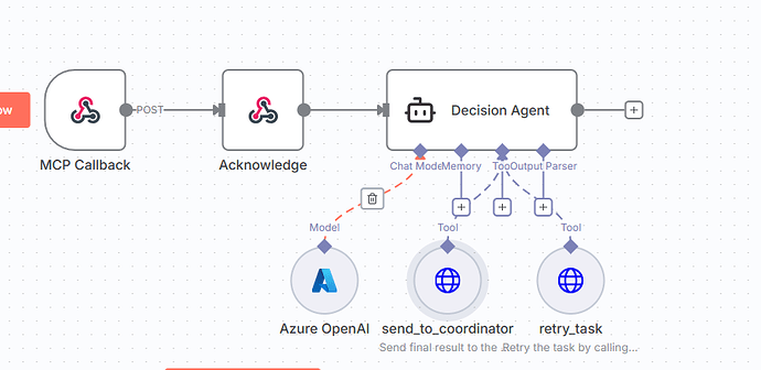

**Each Sub-Workflow:**
1. Performs its work (calls external LLM via MCP, takes 2-5 minutes)
2. When complete, sends an HTTP callback to a “Collector Workflow”

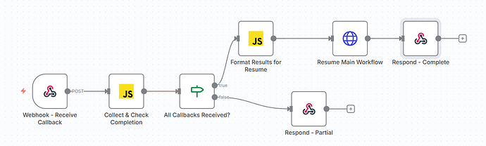

**Collector Workflow:**
1. Receives callbacks from completed sub-workflows
2. Maintains a counter of completed tasks
3. When counter reaches N/N (all sub-workflows finished), it resumes the main workflow via webhook

**Main Workflow Structure:**
**Sub-Workflow Structure:**
when callback return from the long process → call to the Collector workflow
**Collector Workflow Structure:**
